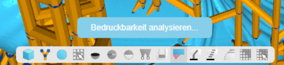

The automatic analysis for islands is running and finds some islands (minima) which are visible through color marks:
When I set a single manual support on one of these island to fix this, the marks disappear, the analysis starts again and I have to wait again for the marks:
Can I stop automatic analyse (and hold the maks for found islands) while setting my supports and start it again when I am ready?

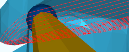

this is no option. When I turn off the icon with the pink island all marks will disappear. But I need the marks (picture 2) to set the supports. I need the option to turn off a running a new analysis, but I want to hold the marks of the last analysis. How should I place the supports, when the marks disappear?
Setting a manual support must not start a new analysis and must not delete the marks. The workflow for a complex figurine is to long because the analysis takes (around 2 - 3 )minutes. When I have 25 islands it will be hours to fix them.

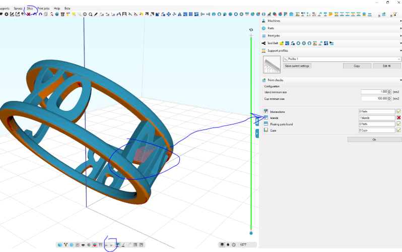

Hi Thomas,
Ok in that case use the print checks command (slice menu). Just run it once and it will keep displaying the islands. With live detection turned off.
s
sturmth 10 Oct 23
this was the hint I needed to do my work. The way You showed me works perfect.
