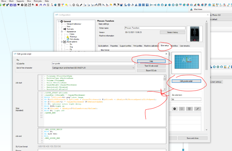

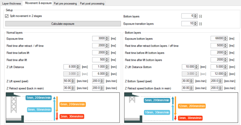

Here my settings:
Sorry for asking - but I never did this before ... I just have the feeling I can control the prints better with
this settings ...
Thanks, Best regards, Chris
formware 5 Dec 23
Hi Chris,
You have to modify the gcode script if you want that to work.
If you click the 'help' button you will be led to the available variables. Amongst others the waiting times.
The 'test gcode script' button allows you to compile the gcode to check for errors in your typing.
The export gcode allows you a quick export to check when the numbers of your profile are entered.
