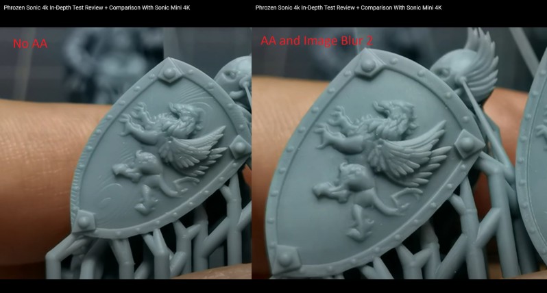

In chitubox it works with aa2 reduces the voxel lines pretty much and if I use with image blur 2 at the cost of surface detail it pretty much eliminates voxel lines. I don't have any pictures to show but a channel named Dennys Wang managed to eliminate the voxels this much:

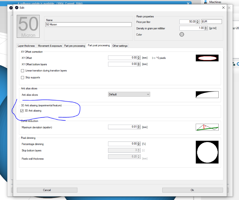

What you can do for now is activate our 3d anti aliasing features. This has been a bit expiremental over time but i think if they claim on that machine that blurring works; then 3d anti aliasing should also have some effect.
3d anti aliasing is not activated by default in print profiles; you can activate it by going into your settings file and putting "SettingAntiAliasing3D" to "true" on the machine that you desire.
This will give you this box:

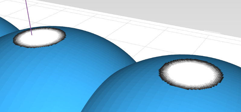

when you then slice a couple of spheres you will notice it also aliases in 3d direction; not just in the XY plane.

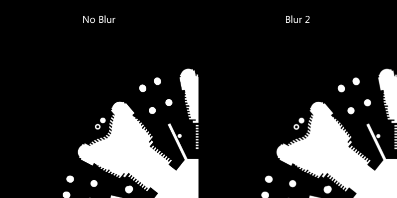

I have seen very smooth objects printed from Chitu slicing with Blur 2. May be you would consider adding Blur as an option?
When "Blur" enabled Chitubox adds a "fog" around the edges of the object. But I think that mathematically the real effect is that the antialiasing is calculated not for perimeter pixels only, but across an outline of 2 pixels width (perimeter outline + 1 pixel witdh area outside).
Below is a comparison of "No Blur" and "Blur 2" extracted via UV Tools.
