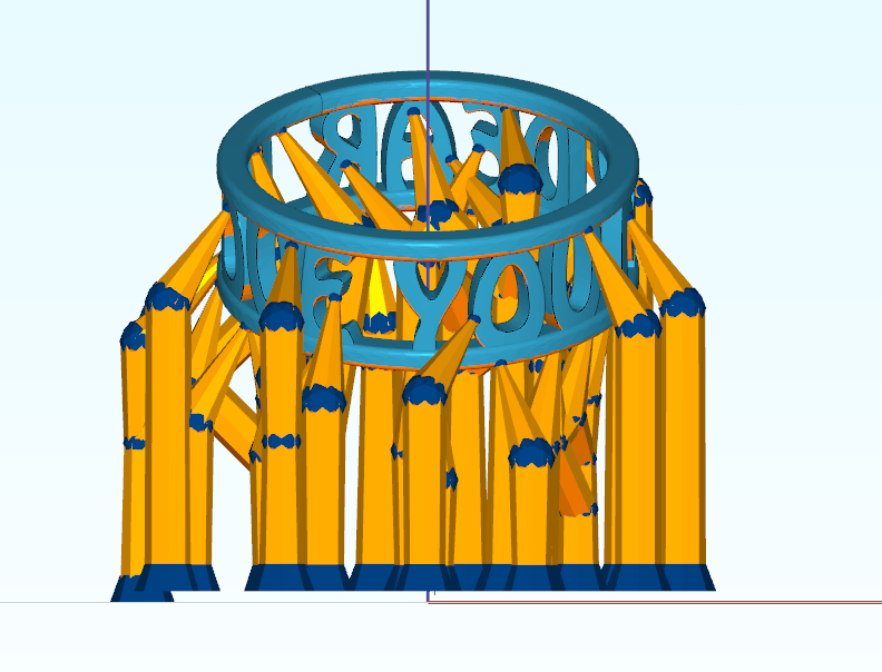

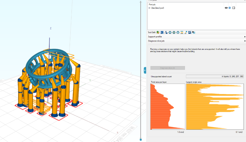

I've got a tricky model that isn't responding well to automatic support generation. I spent a couple hours meticulously supporting the spots that need to be supported and putting the feet where they wouldn't interfere, then cross-bracing them for strength. Then I printed it and discovered ruined FEP, I assumed because it detached from the baseplate. Changed the FEP, started it printing again, happened to look at the screen and saw that it was printing one foot. Opened it in Chitubox and behold:
<img src='/uploads/default/original/1X/001c06592f0f0aa7eaa59e52e0a30717f8280d63.jpeg'>

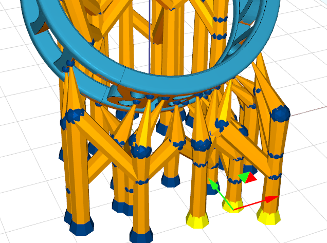

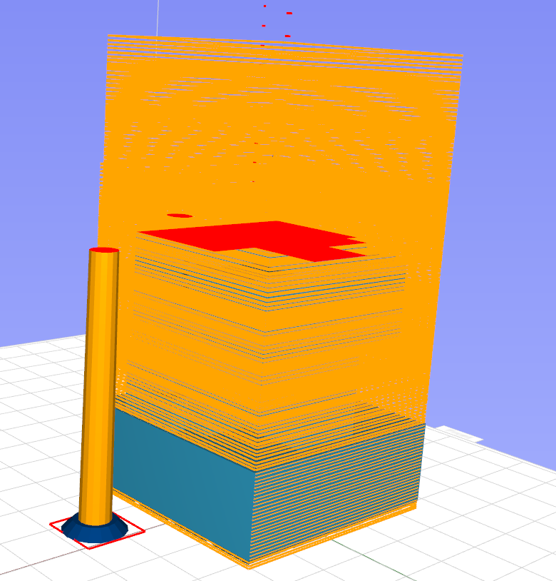

Dig back into the model and found the problem:
<img src='/uploads/default/original/1X/39eb87897ce614722eb35ddda48a6e7c401526b4.jpeg'>
So it looks like what happened is I managed to drag a foot below the ground plane. Then when I sliced the model, it reset the ground plane. As a consequence, I have one support... and then 63 slices of air, and then the model resumes.
Worse, there's no way to repair this. I can move that foot to "zero" but Formware has foresworn it and colors it gray. It's not on the same level as the other feet. So I gotta start over.

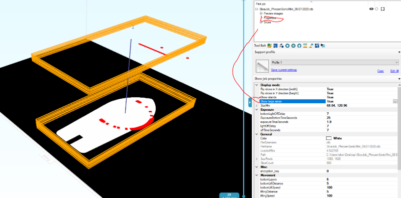

Also downloaded 10.3.3 which apparently has "check for updates" in it so that's awesome. Question, though - is the "largest single area" bounding box supposed to look like this?
because if so, I think I'd like to be able to turn that off. It also looks like the arrow keys allow me to scroll through layers, which is useful. Is there a keyboard shortcut to jump between unsupported islands?
formware 13 Nov 20
Yes that looks a bit overdone printing a rectangulage thing... ;)
I'll make some logic to turn if off if in >10% of the layers.
There is already a toggle to control the display in the job properties (joblist properties, top menu or rightclick black slice preview):

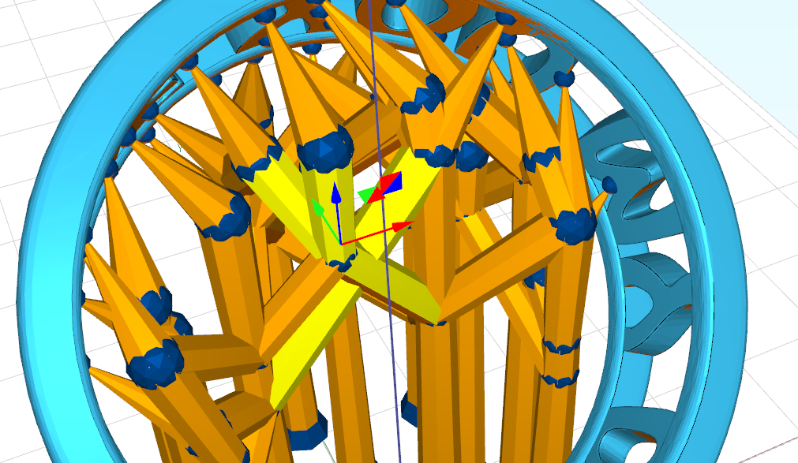

Regarding the accidental movements below z.
I've rewritten the code for what 'movements' are available in the interface when an object is selected.
It will now detect what 'types' of support geometries you have selected. (i.e. foot, tip, center joint, beam)
Then it will find the union of all movement options for each item.
i.e. you select a couple of feet; it will only show you X, Y and XY
i.e. you select a part
A beam in the middle has more options to move:

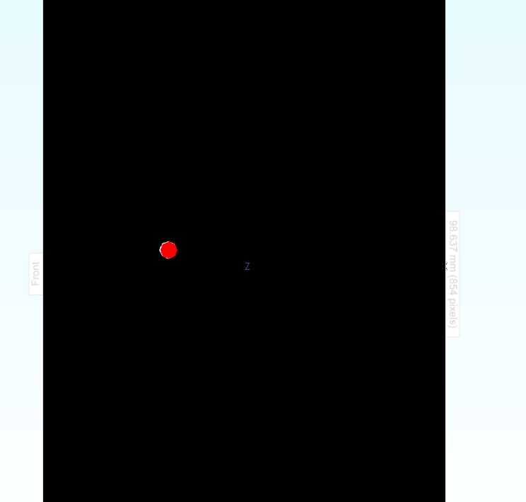

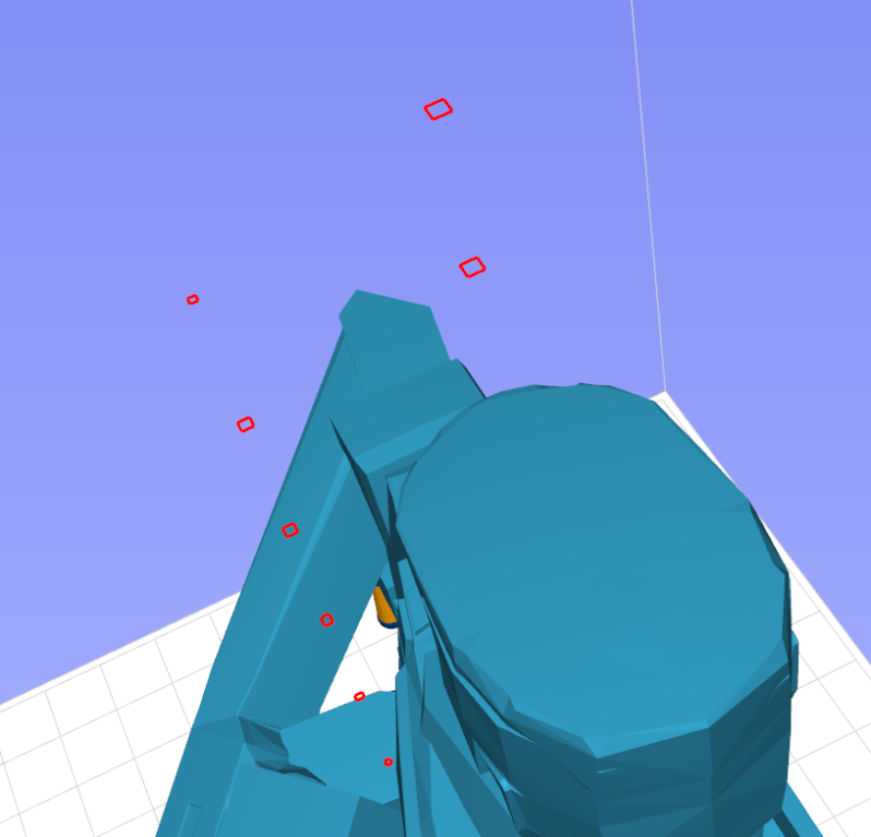

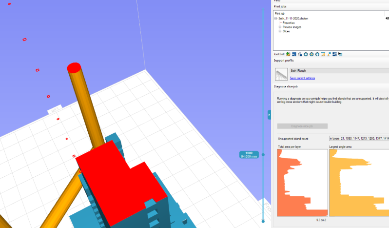

What method are you using to find islands? It appears to find a whole bunch of areas, one on top of the other, that it thinks are "islands" yet have never been a part of the model. They're out in free space.
This is the top of the model, complete:

Island detection: it works with a floodfill in 2D.
Can it be the printjob is flipped in X or Y direction??
Use topview to inspect the layers. Zoom in far enough and you see what pixel is causing the island... ?

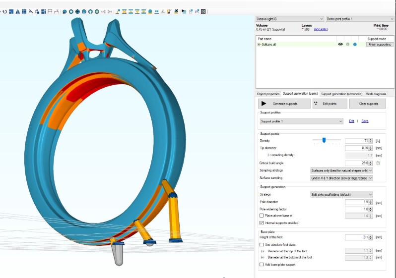

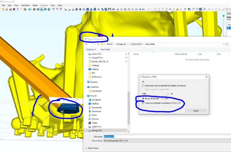

I have made a few posts about manual supports being generated under the build plate since about 18 months ago. There is a check box in the export that cuts the offenders off but ...There are multiple untrapped errors.
Dragging the support to a more acute angle to clear your model will cause the support trunk to penetrate the foot and bite into the plate. That is because the shape is 90 degrees to the trunk One solution is to make the base of the trunk in the foot semi hemispherical. The other cause was parameterising the min foot height when using very short supports. If min foot height and support height > Z0 to model attach point, the foot penetrates the build plate. Workaround -don't tick this box or program it to start measurements at the base of the foot==Z0 and warn if the specified support is too long in total.
