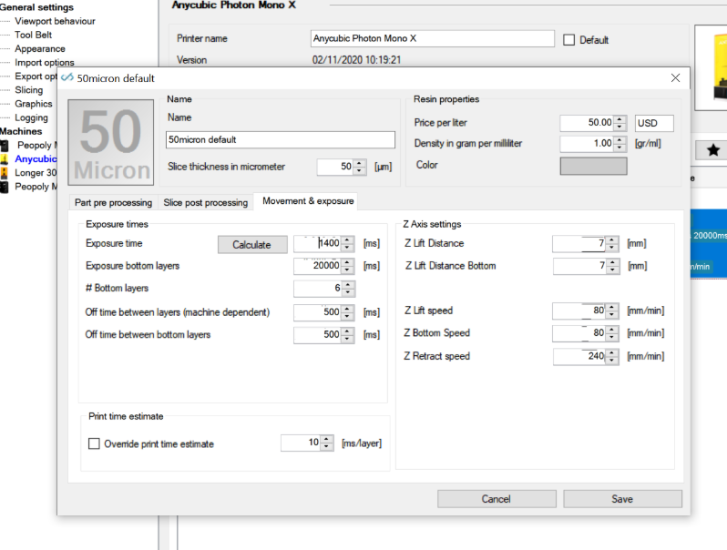

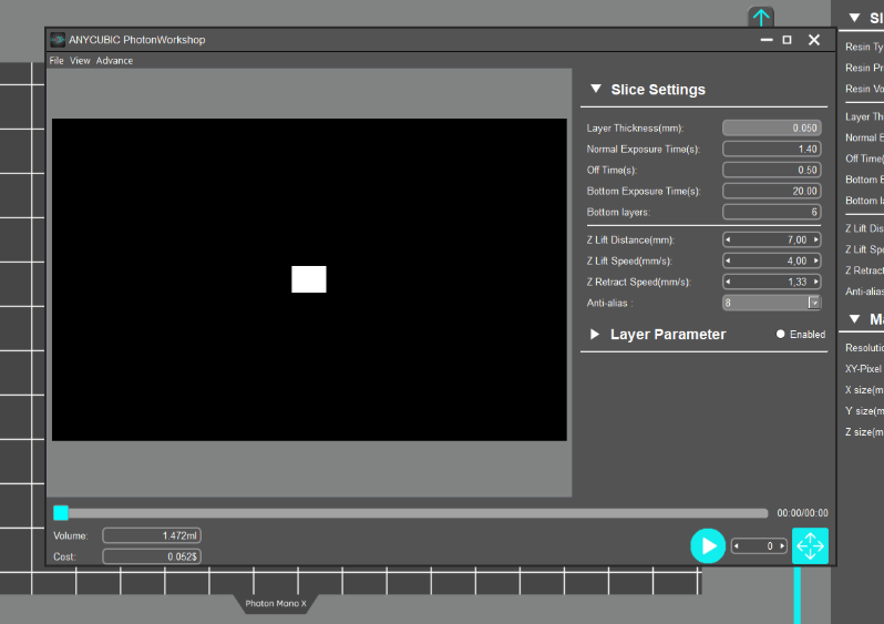

first feedback:
-retract and lift speed seems reversed ( during print z lift is quicker than retract)
-file is recorded as pw0 ( manual change to pwmx seems working)
s
sylus 2 Nov 20
inversion confirmed
s
sylus 3 Nov 20
File extension and Speeds fixed
s
sylus 3 Nov 20
pmwx extention fixed on today version,not the speed inversion
formware 5 Nov 20
Hi sylus,
I know. The speed inversion is a misunderstanding on my part. I always assumed 'retract speed' as 'pulling back', or 'pulling up'. So it's named wrong.
The top 2 speeds are the 'peel' speeds.
Teh 'retract' speed field is the speed going down again.
We wil need to rename it and double check the machines.
Coming.
