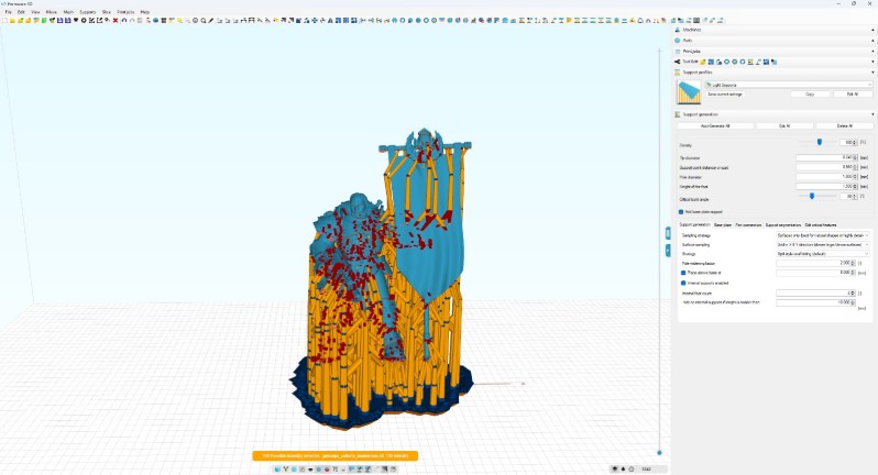

Model getting ready to slice and when I use the Auto support option they run all through the model. I am using the free version but am looking to upgrade if I can get this looked at. Am I doing something wrong or is this a fixable bug.
formware 7 Jun 24
Hi Kai,
Long story, but there are 2 intersection calculations. This one is the most accurate but it will also show you all near intersections with the tip part. It slices the model and looks for overlapping curves. But this will also show tip-beam intersections at this point in time.. so they are not all strictly intersections.
I need to make some adjustments in how the first part of the tip is connected; so you see a bit less.
You can see the larger ones however on the top right; i would fix thos.
Furthermore, i would perhaps reduce the pole size a little; it seems a little dense to me.
Wouldn't a better orientation b eon the back of the sculpture?
It seems like you have a lot of very small overhangs in this orientation. That is always very tricky with this print technology.. ideally you would have them face upwards as much as possible.

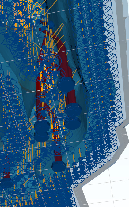

Elco,
Related to the above post, i've been bumping into a similar problem.
Although i do not care much about the "tip" intersection, i do have issues with support pillars intersecting the model. See attachment
For the most part, the auto supports works fine.
However, in the attempt to get the tip under the required angle on the model surface, the support beam gets forced into the model surface.
It makes removing supports a lot harder. I just broke an uncured piece this morning because i tried to pry out uncooperative supports that were fused with the model wall...
I tried to force an angle (fe 0°) but that didnt yield any good results.
Atm I use the wireframe mode to identify the offenders, and manually move them around until the pilar is no longer "red"... but it kinda defeats the whole point of using the convenience of autosupports...
I'm no programmer, but is seems to me that, atm, getting the right surface angle has priority over collision detection, where imho, it should be the inverse ?
Or did i simply overlook something that can be turned on?
UPDATE :
I got better results now by shortening the tip length, but it still has some perforating supports...
