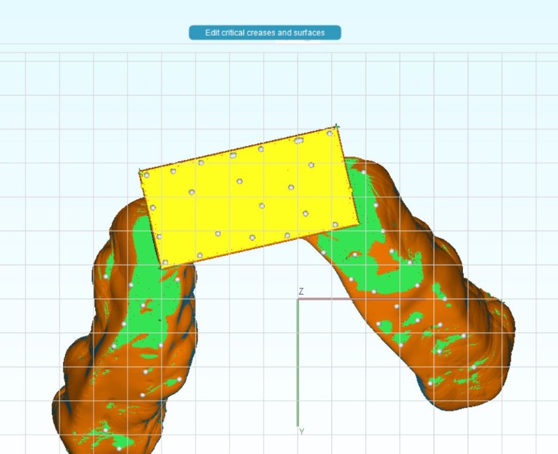

Is it possible to select only an area of the object, in which only the software can insert generated AUTO supports?
formware 23 Mar 21
[quote="Marco, post:1, topic:710"]
Currently not.
What you can do is autosupport the object and then delete any features (surfaces/creases) you don't want supported. Click 'apply' to regenerate. It will regenerate without these locations.
M
Marco 23 Mar 21
Thanks a lot. Where is the "apply" button? And before that, how do I delete the features (surfaces / creases) I don't want supported?
formware 23 Mar 21
M
Marco 25 Mar 21

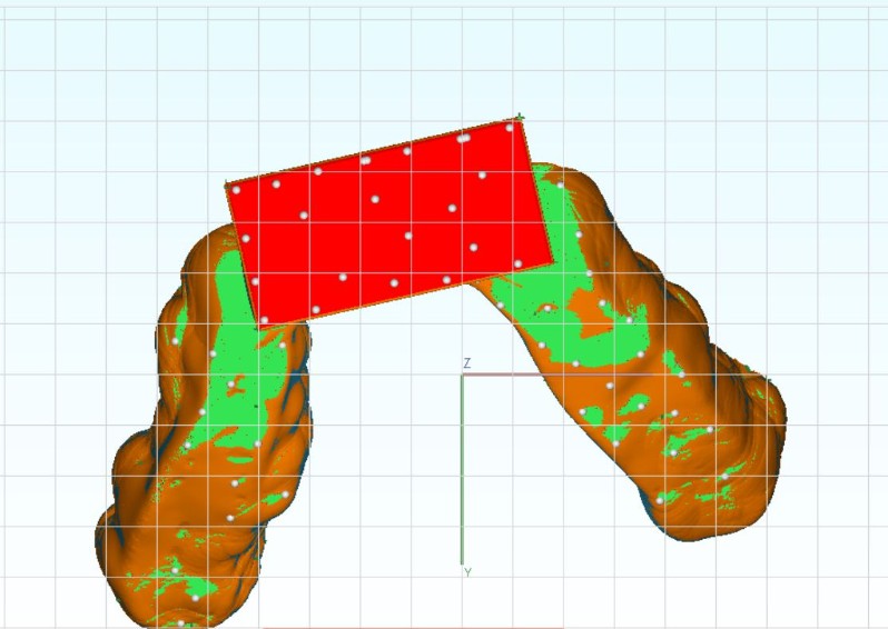

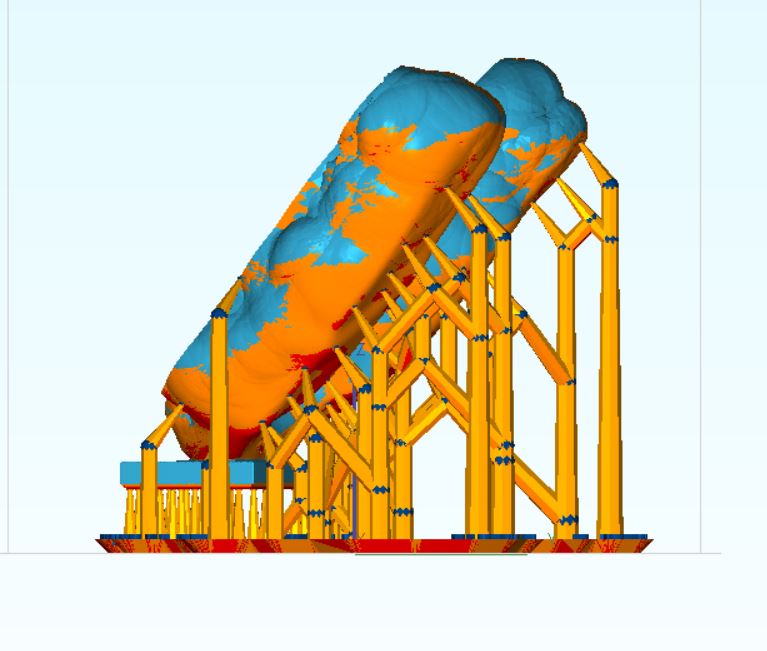

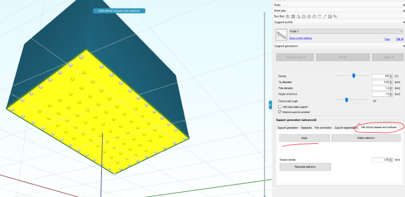

Thank you. I tried but failed. In this specific case, I would like to print the object (1.jpg) using both the raft on the build platform and the supports on the remaining areas. I followed your advice, first creating the supports (2.jpg) and then editing (3.jpg) and deleting (4.jpg) the surface . But with the "apply" button the software has regenerated all the supports as before, ie including the erased surface (5.jpg). Thanks again for your kind and knowledgeable support.
formware 25 Mar 21
So i think I misunderstood what you are trying to achieve.
First there is a toggle in the support generation panel 'place above base' .
Uncheck this box and it will not move the object vertically. Probably this will achieve what you want
It won't apply any supports on the bottom of the object.

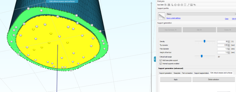

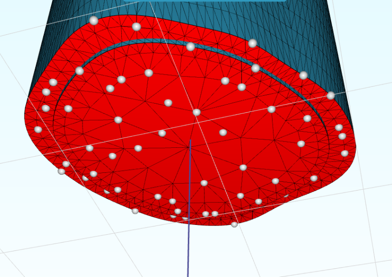

Second, when I look at the image if looks like you selected the surface but the grey dots are not yellow.
So there is something going on there; they should highlight as well 'if' they belong to the surface. I only see 2 selected.
The reason for this is a hierarchy in the type of underlying support points.
When placing point it goes along these lines
  1. sample z minima (a vertex that is the lowest point compared to adjecent vertices)
  2. sample edges/creases
  3. sample surfaces
    Then it applies a global filtering which takes the same hiearchy in remove points. (a Z minima is 'super important' to not miss. a surface point is less important and can be removed if it's to dense)
So in this special case of a flat surface (XY plane) you have a number of 'z minima' that are getting points. It might be there is some rounding errors in the vertices that cause this; i'm not sure. When you look at the second image below you see the points are sometimes exactly on a vertex, these are Z minima for sure. So probably this is also rounding error causing this.
The solution would be simple if you want to remove these points as well.
Just 'drag select' around the points with your mouse (drag a rectangle) and they are gone. You can do this in bottomview easiest for a surface in the XY plane.

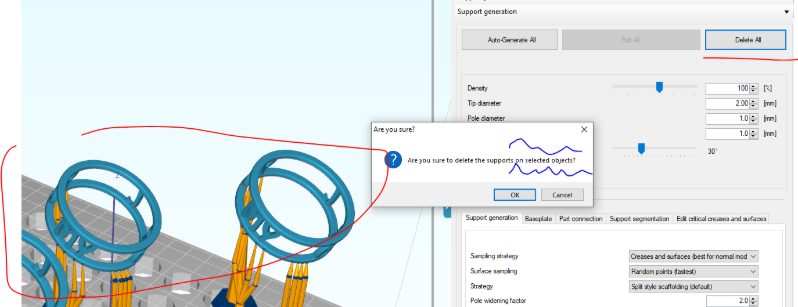

  • Delete supports from 1 part only: select the part and then click 'delete support'. It will ask you 'delete part from selected supports?" (using the command from the toolbar)

And click "apply to selection", right? I can't even click on a whole support:
[quote="formware, post:13, topic:710"]

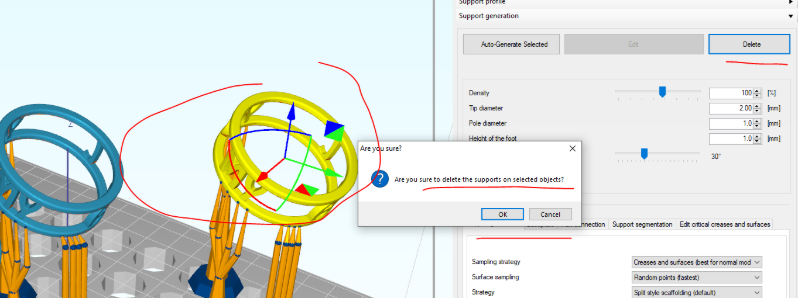

Delete supports from 1 part only: select the part and then click ‘delete support’. It will ask you 'delete part from selected supports?" (using the command from the toolbar)
It... does work that way - _but only on the horizontal pulldown menu._ You don't phrase it "delete part supports" you phrase it "delete all supports." On the other hand, if you're in "support generation" on the right-hand side, "delete all" deletes all supports on all models. Unless some models are hidden. I imagine I could get used to it if I were using it every day but generation is only a third or a quarter of my process so by the time I'm in Formware again, I've forgotten a lot of the idiosyncrasies.

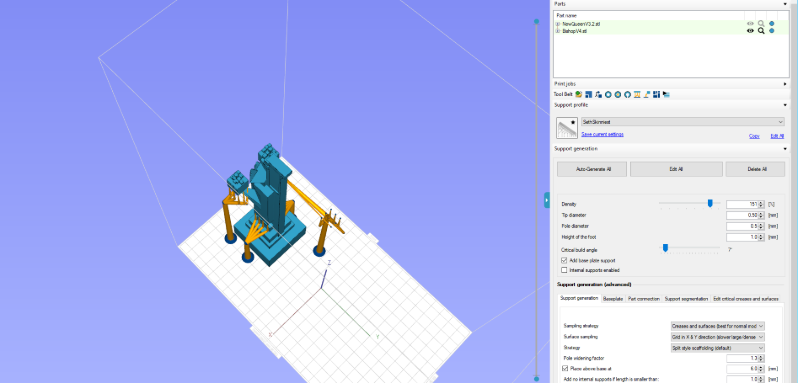

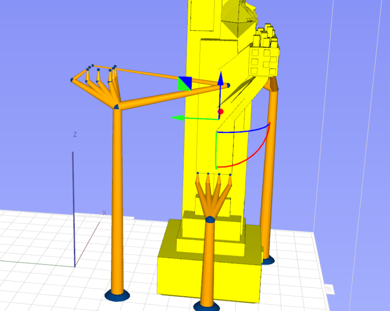

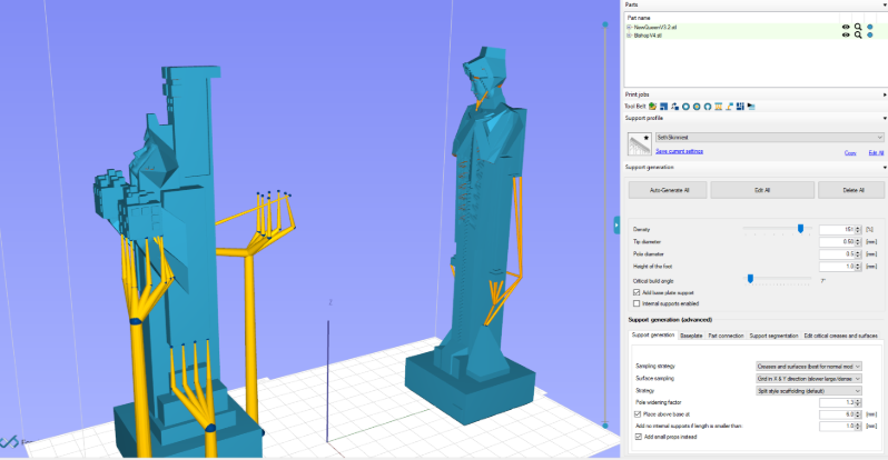

1) Open NewQueenV3.2_Supported, a Formware3D file
2) Move NewQueenV3.2.stl out of the center of the build platform by grabbing one of the bicolor flags
3) Import Bishop_Supported, a Formware 3D file
4) Move BishopV4.stl out of the center of the build platform by grabbing one of the bicolor flags
Here's what the supports do:

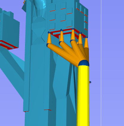

Of the four supports on the bed, three of them moved with no problem. One of them, the base and anchors stayed put, but one of the connecting knuckles moved. Why? No idea. What can be done? Nothing. The whole file is corrupted at that point and I need to close out and start over. The supports are partially associated with the model, but their level of association is random, subject to change, and there's no way to predict what will happen next. What's even better is that even though there have been exactly ZERO moves in the Z direction, when I go to slice I get this:
In this case, it's useful to nudge the parts 1 by 1 onto the bed, which is when I discover that one of my abortive auto-support moves bumped the bishop (and three of its supports, but not four) 5mm above the bed. So the auto-support routine (1) deleted all supports (2) moved the model up 5mm (3) supported the model But when I CTRL-Z undid the auto-support, it didn't reverse step (2). Worse, it put the original supports back 5mm above the bed. The useless support? It stayed put the whole time.
Most of the time when I go to slice these days I have stuff that hasn't been moved (because I'm not auto-supporting) but I have to re-zero everything to the bed anyway because there's some part of Formware that thinks the models are some minuscule fraction of a mm below the bed for some reason. Or maybe I'm just clearing a flag. I don't know. Sometimes it doesn't even let me clear the flag and i have to go "okay, try printing anyway" and hope it's not writing a few slices of air between the bed and the model.

- moving parts+supports: A move in XY, X, Y or rotation around Z should always drag along a support with the same transformation. If not this should be a bug. I tried to recreated it with a tree support but it can't find the same behaviour. If you are allowed to share the file please do so over email.

- delete supports -> correct the text in the dropdown is confusing. Also noticed there is a delete command under 'edit' as well. Needs cleaning up.
- I'm doubting now if the interface is at all clear with the buttons changing texts depending on part select. Did you notice this? I do agree when non is selected it's strange to put a confirmbox with 'selected objects'
