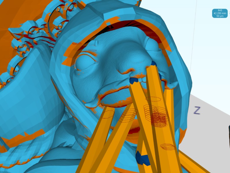

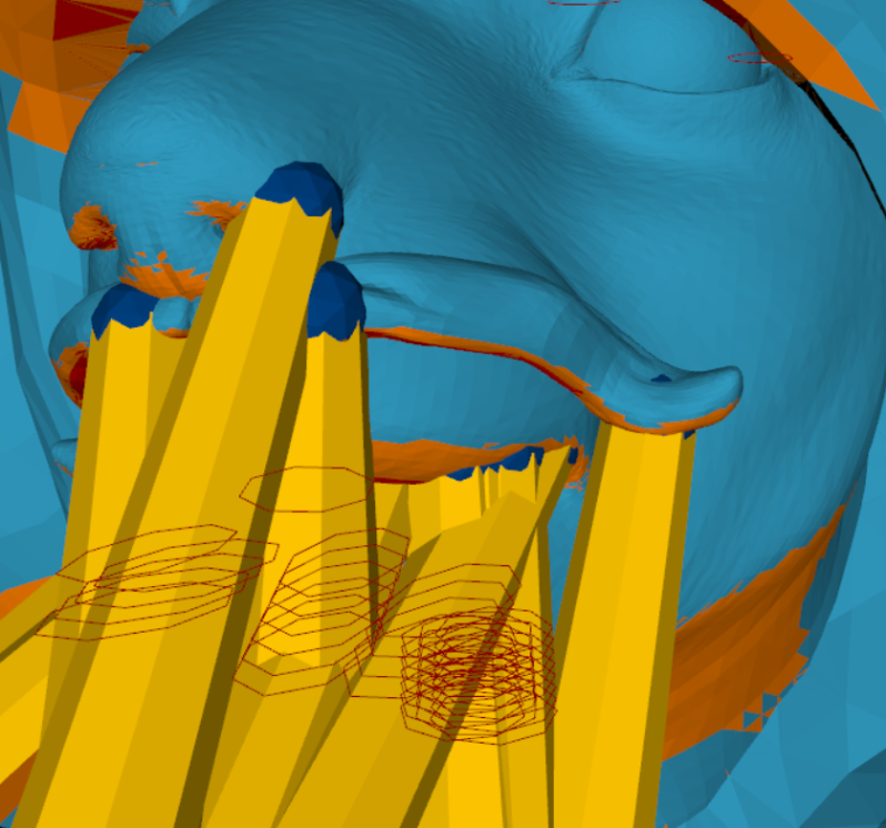

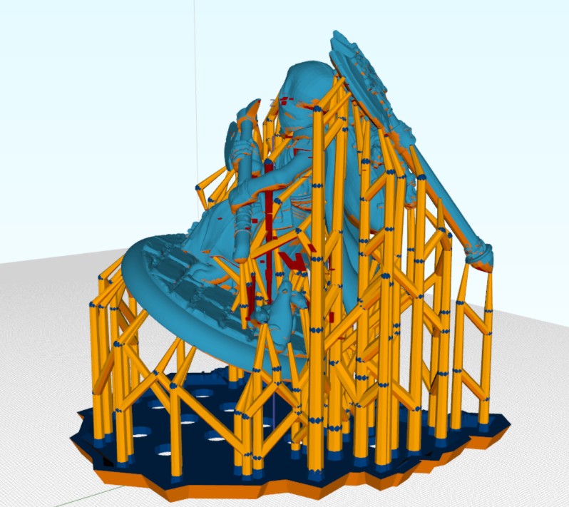

Hello, Formware fans! I just updated Formware and my automated support profiles aren't playing nicely. Frankly, they look gross and have far more intersections than they had before. Below are some images that show the problem. Dozens of support nodes can appear in a small spot at times, and place supports within supports. Has anyone else experienced this?

What can you do? It looks to me like the diameter of your columns are a bit large compared to your model. The model has relatively a lot of detail.
So I would take a small tip size and main diameter, if your material/process allows.
That basically makes the calculation more accurate. Because you give the 'algoritm' more freedom to try alternative orientations. They have a smaller chance of intersecting.
In the end; you will always have to do some manual editting/dragging.

One thing I've noticed is that auto supports may behave (more) strangely if there are errors in the model. I check, and repair if necessary, before generating supports.
