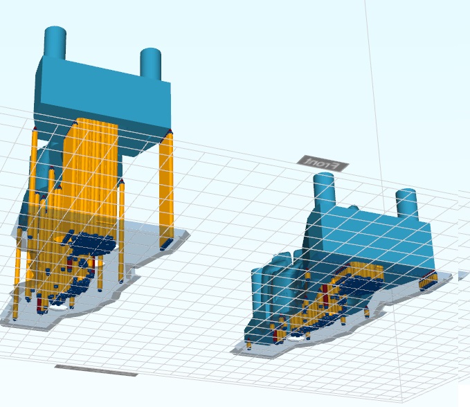

Using a customized automatic support generation to support flat surfaces. (paralel to baseplate).
On parts with a relativly large surface area, the dense supportgrid is generated correctly.
On smaller flat surfaces almost nothing is generated, with exactly the same automated support settings.
To illustrate the problem I joined a screengrab: I just X-scaled the object x2.2times in the Xdirection, so it is basically the same object, but with a larger surface.
I think i tried all possible automatic support parameters, with no difference.

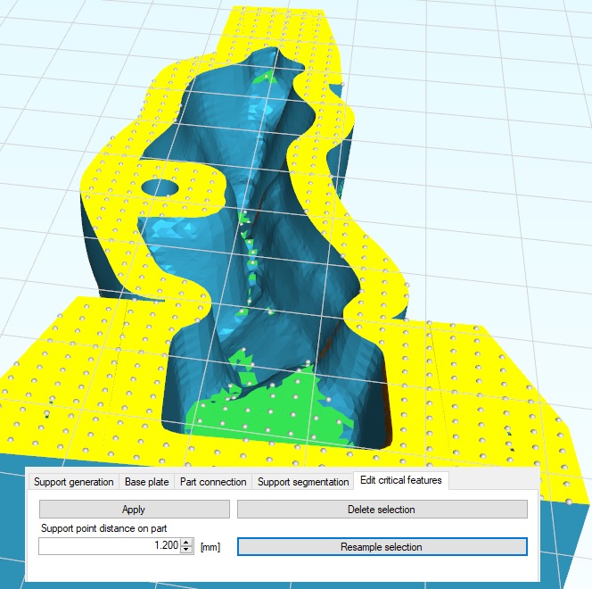

However, if I go to "Edit Critical features" and select the flat surface (turns yellow) and ask to resample the selection, it indicates the correct grid positions for supports. Sadely, when hitting "apply" , no supports are generated...!

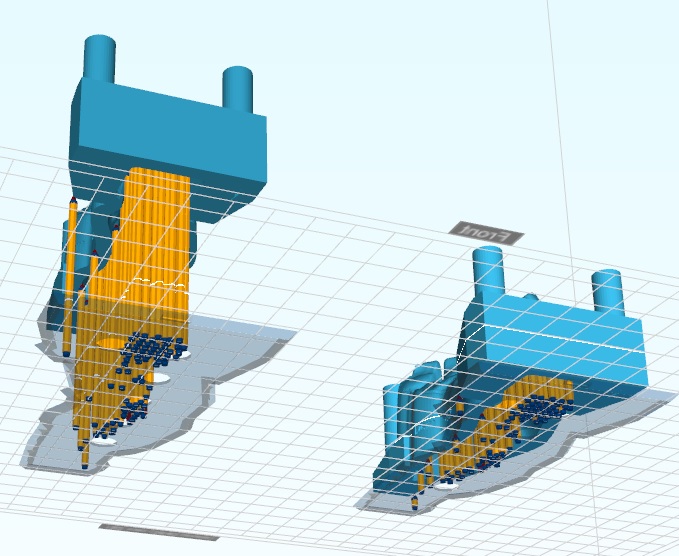

When I open the part and run auto supporter (version 1145) the result looks like this:
So i'm suspecting some kind of parameter combination or floating point error that produces this.

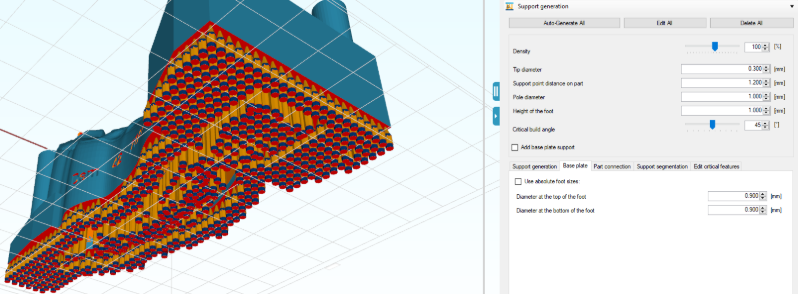

So after some investigation; this is indeed a bug caused by parameter combination. Thanks a lot for reporting it.
I'll correct it right away for the next release.
If you set the first beam length very short (1 mm in this scenario)
A check of intersection of the first beam with the part fails. (because it flips a normal, and thus finds an intersection inwards of the model).
So what parameter to use to avoid it for now:
First beam length should be larger than 2x the pole diameter.
In your example the pole diameter was 1.2
The first beam length (only) 1.0.
So if you make your first beam length 2.5 it generates.
There is no correlation to the scaling of the model. I have the same on the scaled model.
It could be the support profile you generated that with was different. Not sure. But this is definitely it.
