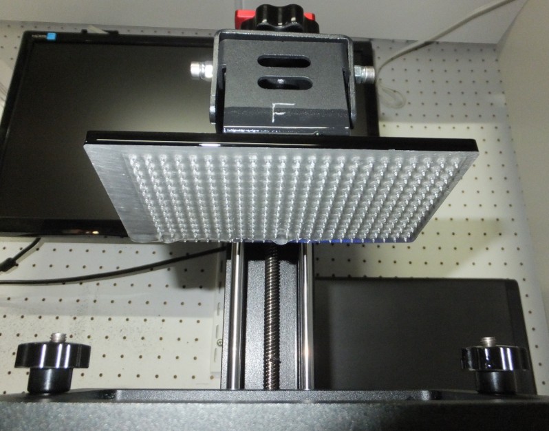

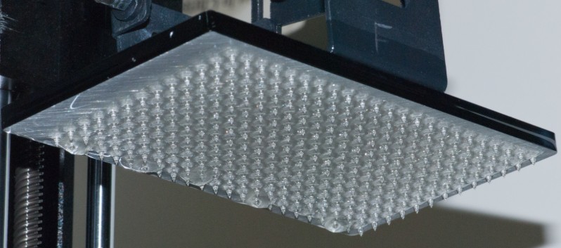

Is it worth all the trouble? Yes. Check out the full bed test print of pylons covering the full bed.

To print without a mask uncheck to use the mask in the DLP settings and use recommended exposure settings from the resin manufacturer but print only in the central 5cm x 5cm region.
Here is a simple block that covers the full bed. I use this to 'print' the mask on the vat just to see what it looks like, check the 'how to' doc for more details on that.

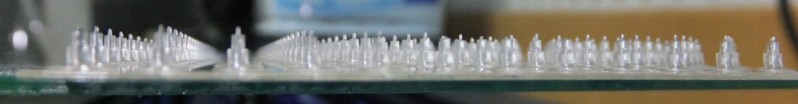

The calposts stl file I used in the images is too large to upload. I don't recommend printing this to start because if the settings are not right you end up with hundreds of tiny discs in the vat. I am checking on getting these files to you with Formware.

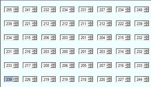

Finally here are the actual Step 3 values for the full bed mask in a screenshot:

Finally, proof that the new settings work is shown in this image.
Sorry about the confusion but I really had no idea this was happening until I printed some parts with text on them.
