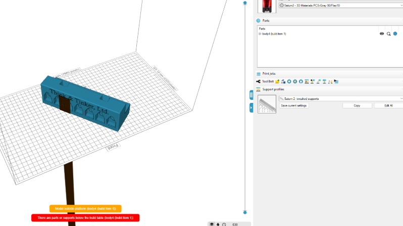

The latest update (1176) cannot save and open .fw3d files. When I create a new file, import and orient components and then save it, the file cannot be opened. None of my previous .fw3d files can be opened.

I uninstalled the software and reinstalled using the latest stable .msi (1176).
Both of these files were saved using SAVE, SAVE AS (and, as a last resort, EXPORT). When I try to load ANY .fw3d file, I get the same error.
When I try to OPEN or IMPORT the file, I get the checksum error
I have also uploaded the configuration file in case something in my setup is causing the problem.

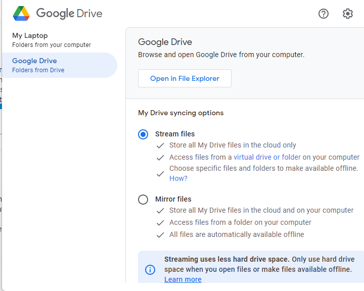

I think we have found what the problem is. The key to the issue was my misunderstanding of how a Google drive works. I assumed that the Drive app created a true mapped drive on my local system. Apparently that is NOT the case. I was not aware of the constant movement of data between the cloud and my local "copy" and its potential effect (bit rot) that might occur when the dealing with a less common format like 3mf or your fw3d.
I exported new copies of the 3mf to a local SSD, opened in Formware (1176), and saved to the local SSD as an fw3d file. It opens just fine. No problem at all.
The problem seems to be that running through the Google drive adds some form of corruption that may not be the same each time. This is consistent with what you found when trouble shooting the files.
I am sorry to have wasted your time on an issue that was basically caused by my lack of understanding of how cloud services work.

If I remember correctly there are 2 ways to use google drive, stream or mirror.
Which kind do you use then?
