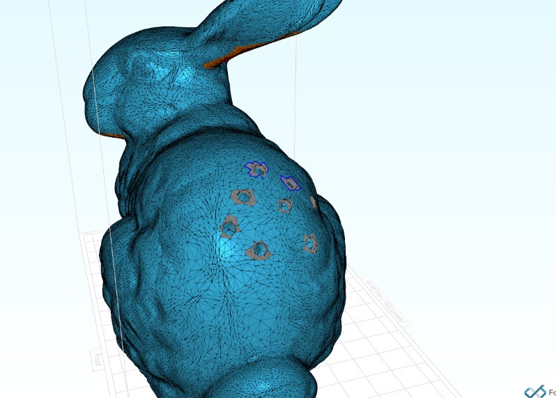

formware 1 May 19
almost there... just need to make it error-proof....

formware 1 May 19
Yes no worries. It's just an image from my debugging console... the gray triangles are to be placed in the general mesh. (they are gray so i see what i'm doing ;) )

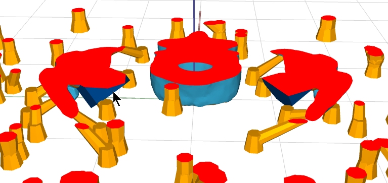

Just to be clear though I am not exporting the part to STL, just slicing it normally. In the slices the drainage holes are solid so no holes appear.
In the image the cursor points to one of the drainage 'holes'. It did not cut through the part but remained as a solid. The part is light blue and the drainage holes are dark blue.
formware 2 May 19
Hi Tony,
Yes that's correct behaviour.
Once you start slicing it will revert the meshes and create the actual holes.
You see the hole in the PNG's.
I've finished the boolean implementation yesterday; need to wrap it up and polish it.
So a 'real' hole will be possible in couple of days from the software.

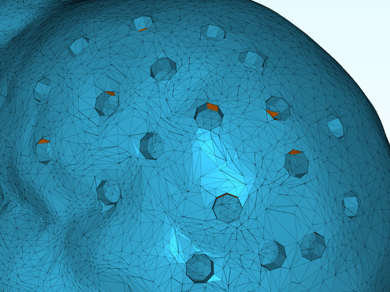

formware 3 May 19
I've uploaded a new version of the installer that includes the complete boolean.
It works better than I expected but still took around 2 days to code. Still far from perfect and you can see i smuggle a bit with the triangulation of the planes near the holes. But I figures; a drain hole is by definition on a side where you don't want it to be seen in your model.
A word of caution; if you do this with very big meshes it will take a memory load because of the 'undo/redo' functionality storing modified meshes.

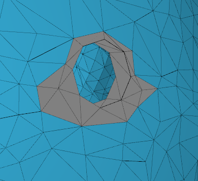

formware 3 May 19
another nice image of the bunny's back with triangulations:
:D

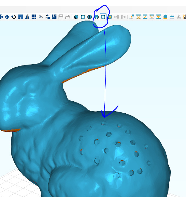

formware 3 May 19
there should be 2 buttons for holes now.
I left the other option as well...
tasrgi 3 May 19
I didn't see it. Sorry.
I am glad you left the other button because the new format requires a lot faster computer.
I tried a few models. Generally the holes work well but in some cases around the hole is a thin wall coming up from the surface. After the hole process is finished there is an error in the part shown as the warning sign beside the STL part name.
tasrgi 3 May 19
It appears that if i place a hole where there is geometry just behind the wall this is where the errors occur.
It just requires a bit more care in placing the holes. Then they work well with no errors in the STL file.
