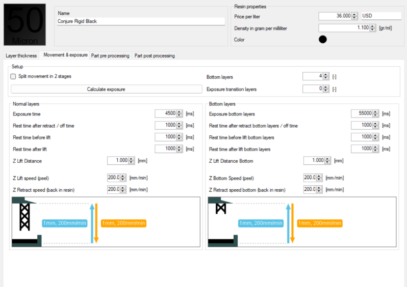

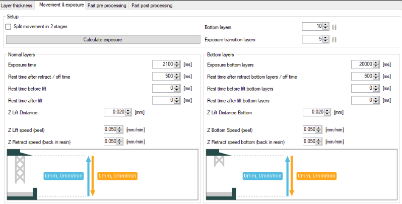

Hi, i can try and help: see my settings bellow in the image, these yield almost the same speeds of a file sliced with chitubox. I hope it helps.

gonzalo 1 Sep 24
Once Elco updates the software where we can set distances and speeds to recieve any value (we need to be able to imput 0.05 here and there) it will be perfect.

gonzalo 6 Sep 24
Hi there,
So what difference will the 1.00mm vs the 0.05mm still make then?
The tilt vat mechanism does the peel and detach, NOT the movement of the head. On this machine, the head only moves up by one layer thickness at a time. It does not move up and retract.
If the value is set to 1mm, the head will lift 0.05+1mm and come back in 1mm where if the value is 0.05mm, it will not retract at all, will just lift 0.05mm. The speeds we enter in Formware 3D are affecting this movement alone. So, if you enter 1mm/min (and we all did that trying to get to that 0.05 value) then you have a very slow movement up and down. If you enter a speed of 200mm/min you are over 3mm/s so thats probably the fastest speed limit to move that head. So, we are lucky that it still works, but we are adding movement of the head that is not intended to happen. Does that help? Thank you for your efforts to make this work by the way!

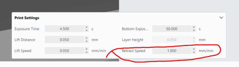

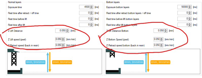

I still think there is something not working correctly. Please look at the two images below:
Looks like the Z Retract speed value is still going back to 1mm/min in the G code, even though it persistently reads 0.05 in the configuration screen.

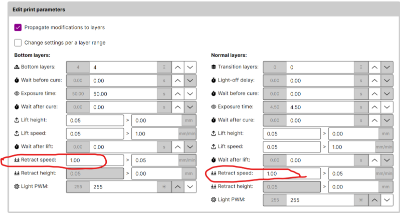

To make sure that it wasnt UVTools forcing a value on import. I loaded the file into Chitubox and there it also shows a value of 1mm/min for Retraction...see below:

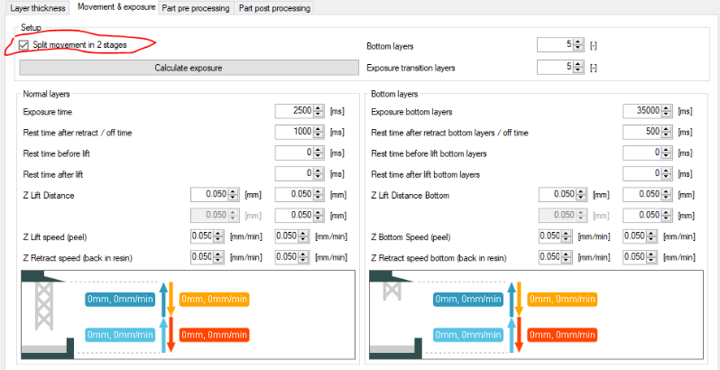

formware 18 Sep 24
Hi Gonzalo,
I think UVTools/chitubox reset values to 1 if they are below 0.05 or 0.
I've checked both CTB (SDK) and GOO output format's.

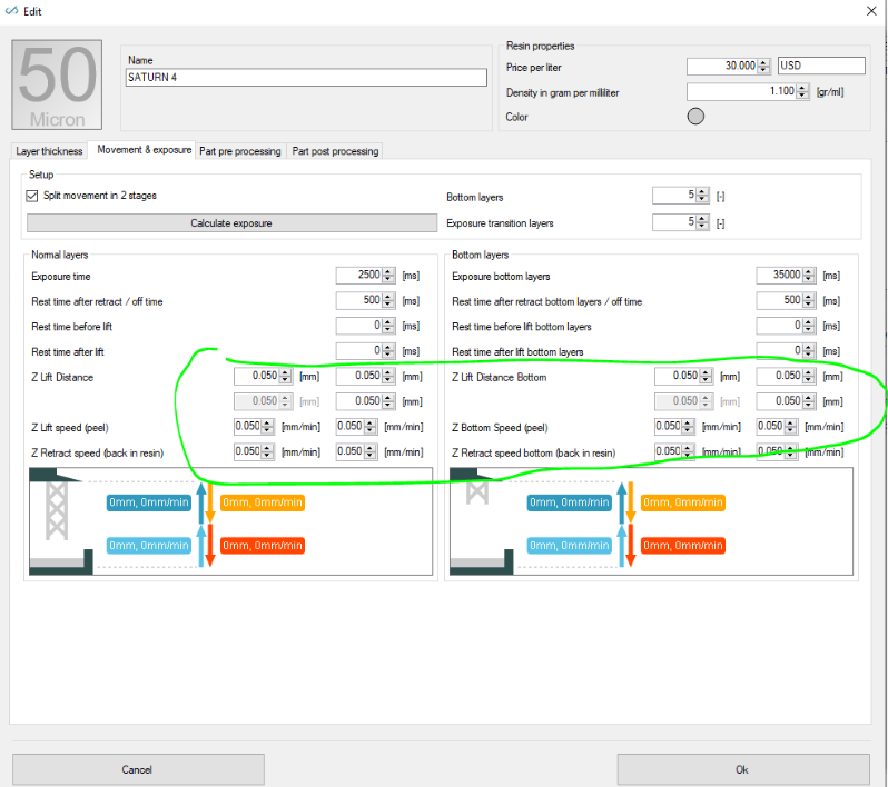

The code write all values to what you put in our input boxes.
If you activate the 'two stage movement' and then enter 0.05 in all boxes, it will work. Then all values are 0.05.

gonzalo 18 Sep 24
Hello,
I confirm, checking the "Split movement in 2 Stages" box and adjusting all Z related distance and speed values to 0.05 works.
Thank you so much for getting this done.
