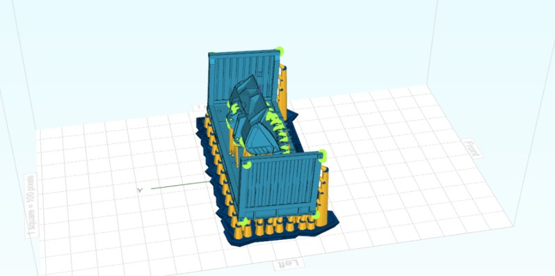

During printing I noticed some problems on the file, so I changed the part in CAD and replaced the old part with the new obj file. Strangely the replace function shifts the part to the side, so it does not fit original position. The basic file did not change position. So the parts origin is exactly the same.
Any way to get it back to its original position? Very strange. I remember that this always worked.
Moving it back manually is nearly impossible. I´m using latest Formware version.

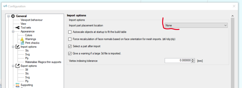

Can you check in the settings what it does on import of a part? (config -> import options -> first dropdown)
It seems like it auto-centers is. Perhaps the 'replace' toggle is not applied correctly somehow.
Perhaps you put that to 'none' it will not center it and just import in the default coordinates (what you want).

No, even with deactivating the auto-placement it does not fit the "old" place.

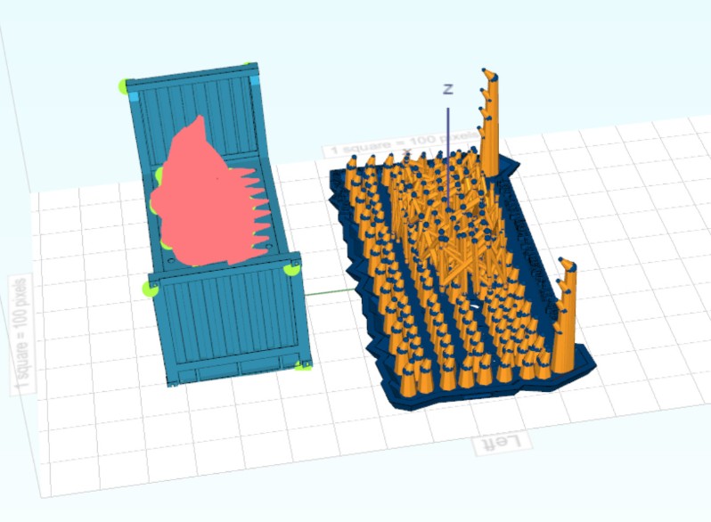

But even with deleting the copy, and centering the part, it shifts the position:

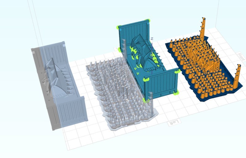

I don't think mesh repair replaces the coordinates.
But if it does happen with the original; then could if be they have different coordinates?
You can verify this by setting the import transform to 'none' (like before)
Then import both meshes. If they have the same coordaintes, they should be on top of each other.

I now found out it is definately caused by Mesh-repair. Before doing mesh repair, you can replace it as often as wanted with no effect to position. After doing Mesh-repair, the part is replaced to an other position. It seems the "base-coordinates" are reset - or something like this ....
I can definately reproduce this happening with all parts I have.
