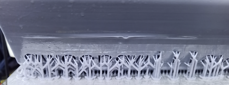

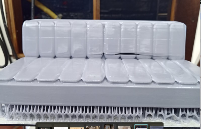

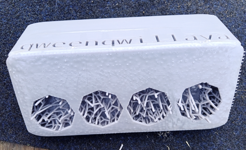

This print takes up the whole plate of a saturn 2 8k machine.
It's been suggested it could be down to suction, but it has plenty of holes. Or a 'wait after retract' needs increasing.
wall thickness is set at 2.4mm. printer internal temperature 30C. elegoo water washable. extra internal supports?

I would print it at another angle or pick another design to be honest.
If you try to print full build plate surfaces.. that's just not what this printing technique is suitable off..
The forces just get to large and there is no force feedback mechanism in these lower end printers.
