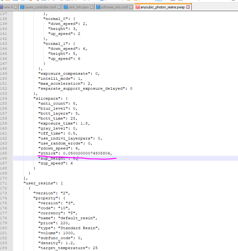

I've inspected the files again but our outputs have the correct height. However:
There is 1 file, the anycubic_photon_resins.pwsp file, it's a JSON file you can just modify with a text editor.
If you look in there there is 1 parameter called zthick; If the printer still prints at 0.05micron, it could the this default setting from this file is somehow used.
It seems very unlikely to me, becease there are layers_controller.conf (json for each layer) and scene.slice (binary for each layer) that contain information for each layer.
If someone could dry test that PWSP file, change that 1 parameter, that would probably move this ahead.
formware 17 Mar 25
Ok update after some better looking.
Photonworkshop reads the 'users_resins' from the anycubic_photon_resins.pwsp file.
Makes sense as the file is named pwsp... = photonworkshop :smiley:
Then there was still 2 different options as you have factory resins and user resins lists in this file.
I will modify my code to also update these outputs to be 1 unified profile matching on what you sliced it with.
The question left is if the printer reads this pwsp file.. I actually don't think so because there should have been more bug notifications. I think our output was confirmed to work correctly late 2024 by some users. Perhaps re-saving the file with photonworkshop creates a problem for the printer?
