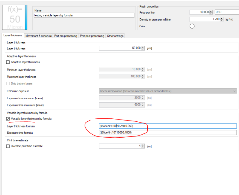

formware 25 Jan 23
Hi Petr,
I"ve experimented with a new approach last weeks for what i think will the solution to all this variable requests.
There is a formula parsing engine in the last version built in already; just not used to the full potential and largely undocumented.
One of the customers asked me to make an adaptable XYOffset. After some weeks of thought I figured; I should just make it a formula; so the user enters the formula. Which can be something like xyoffset=if...else...Math.Sinus(...)
So with IF/ELSE but also math terms.
Basically it works similar in Fusion 360, i don't know if you know this.
I think I would need to apply this logic to other parameters as well.
So for the variable layerheight and speed settings of a print; the problem will always be how to edit it efficiently.
My thought would be to make it an editable formula; quick edit on the print job at hand.

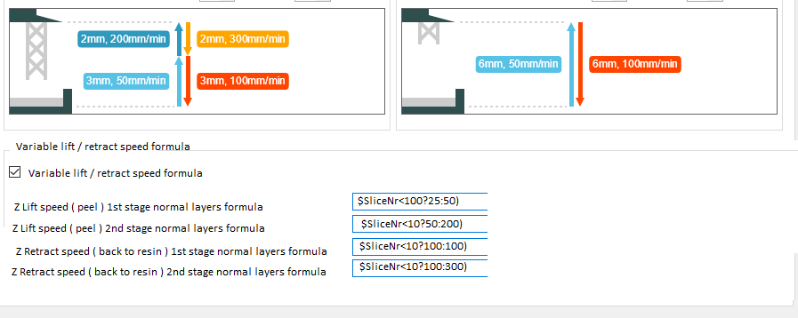

petr 7 Feb 23
I have made more experiments and what I see as most important factor, is to be able to modify lift speed, retract speed and wait time before cure for the first 4-5mm of the print, so formula will be most efficient way to do.

petr 8 Feb 23
I have also other idea how to do this very easy. Use the existing transition layers feature or extend bottom layer configuration.
Transition layers feature take the settings from bottom layers, but just recalculates the curing time to fade from bottom layer time to normal layer time.
If you add option to be able to set the transition layer curing time to static value or modify bottom layer settings ( set curing time for first x layers to some value and the rest bottom layers to other curing time-normal ), this would also fix it.
Now I am doing it manualy on printer, I have set long wait time on normal layers and after 50-100 layers I change the wait time manualy on printer.
All issues with delamination in lower layers in complicated prints have disappeared as the resin flow and stabilization of the machine is very important there.

formware 4 Apr 23
Hi Petr,
Yes this (the formula based approach) is developed and tested, for now just on layerheight and on exposure time.
Upon some feedback i will also add a manual way; to just set the layers manual.
I'm rounding up some small bugs for a next update.
I think for your suggestions for layer speeds we would also need some formula's in speed calculations. However it's a bit dangerous to create a 'huge' UI when what one actually needs is just GCode/NCCode that operates the machine properly.. so it's a bit hacking around these limited file formats in that way. If you see what i mean.

petr 4 Apr 23
Hello, most of the printers now support per layer speed / cure time settings, so it would be perfect to have also the speed settings by formula. Reason is now we print very slow on large format printers, because first few mm we need to go super slow to get perfect results (resin flow ) and later, we can go much faster as there is enough gap between platform to flow resin. Can you think about adding this also to the Movement tab to modify the speeds based on layer height?
