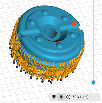

But when I go to "Star Slice" dialog, the field "Resin amount required in your vat" has +/-NaNmm. Also the parts "Total ml" fields has NaN
After slice, below in the [Layer | resin | time] "bubble", the resin option show NaNml

When I start the program, the indicator show the correct indication (0.00 [ml]) but when load the part, goes wrong (NaN [ml]). If I slice the part also the slice overview the Total [ml] display show in the listing NaN in part and Total fields.

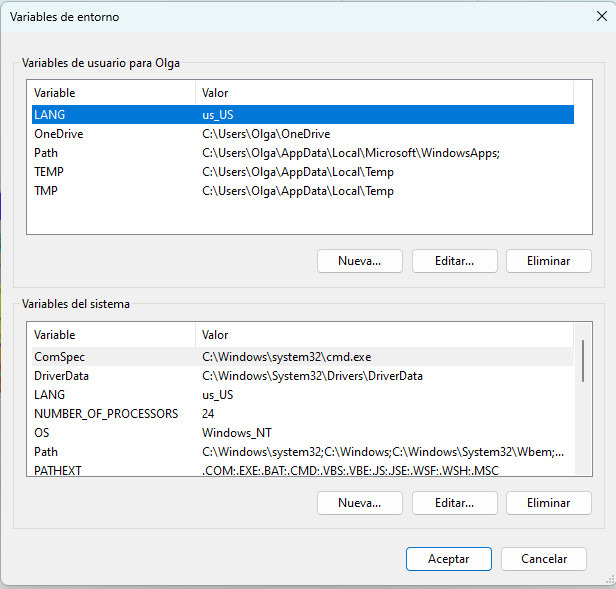

Today after insert the variables LANG=us_US and reboot the PC ths same part goes ok.
In C programs (own programs) I have the same problem If I mix the inputs with '.' and ',' and decimals and locales. The solution Is establish a locale at the beginning and assert the text inputs values to desired locale working in the program internaly allways with only one mode of decimals points.
