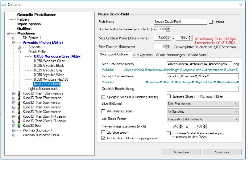

Hello Formware team
I found 3 minor bugs in the latest version of the software.
And that's when I create a new print profile under Anycubic Photon.
  1. The slice size in pixels (width height) does not match that of the Anycubic Photon Displaying 1920 1080 correctly is 1440 * 2560.
  1. The parameter Mirror Slices in X direction (width) is not activated in the new profile but must be set.
  1. The Job Export Format parameter is set to "ImagesAndPrintProfileInfo" but should be set to Anycubic_Photon_File
formware 13 Nov 18
Hi Skink,
Thanks for reporting this. It's because they are the defaults in the code..
You can also copy a profile; then it has everything already.
Nevertheless; picking some smarter defaults might be an idea to improve it..

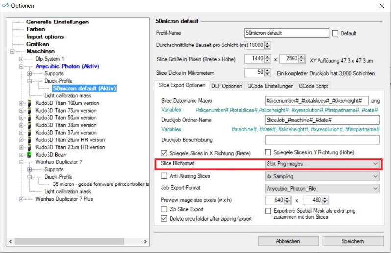

skink 18 Nov 18
Here again the parameters "50micron default" after installation of the test version on another computer. Default value "Slice image format" does not correspond to the standard value for the Anycubic Photon "32 bit Png images" all other values agree with the photon !!!

formware 19 Nov 18
Hi skink,
For the .photon file format they use the amount of bits per pixel is not relevant.
.photon uses a run lenght encoding scheme that just encodes 1 if a pixel is white; 0 if it's black.
(The also implies the light-mask features don't work on a .photon).
Of course this might change.
8-bit (1 byte) is what I prefer to use for 3d printers including our own ones; it allows 256 values per pixel. (i.e. 256 shades of gray)
32-bit (4bytes) is what is most standard in windows drawing libraries; It's a little bit bigger but in .png format still very small. There is no single advantage as you can still only have 256 shades of gray; (remember for white/gray/black all three RGB and alpha values need to be the same).
For all printers i know there is no difference between 32bit and 8bit; except that the firmware of the printer might not understand 8bit. (like i.e. Wanhao D7 that requires 32bit).
Also there are some limits on the width of the image in case of 8bit (needs to be a multiple of 4) if you use certain windows libraries for drawing.
