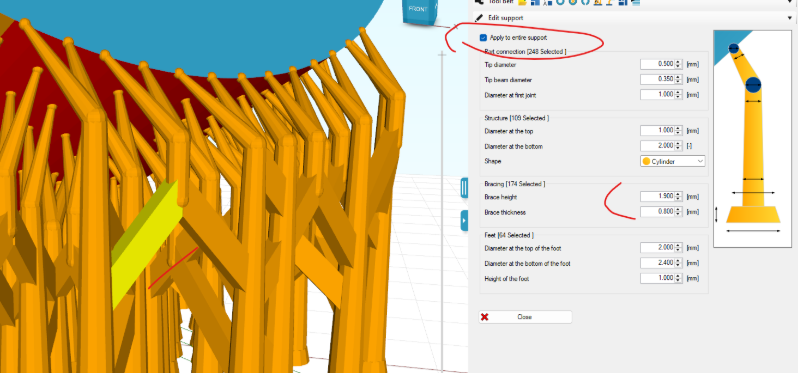

- the cross bracing; you would want them thicker? If you edit the support (right click edit, checkbox 'apply to entire support' and then just modify the bracing. (screenshot below).
