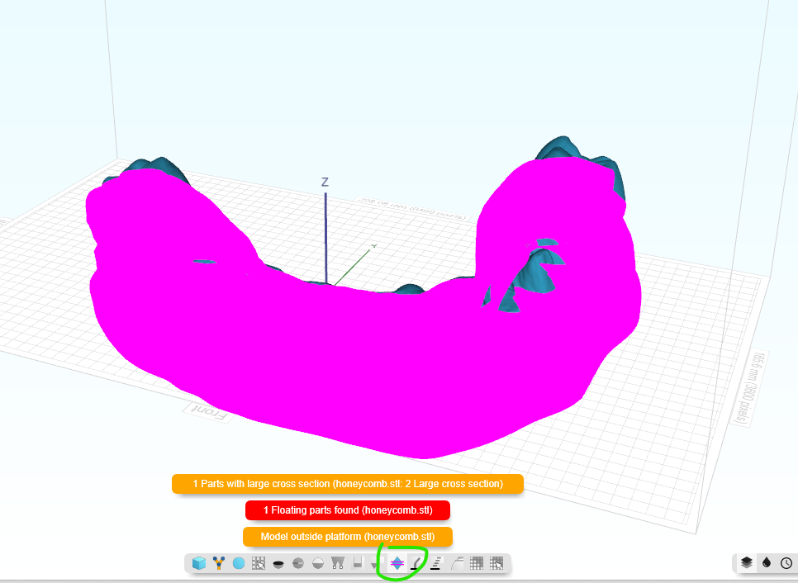

Recently decided to update to most current version.
Ever since at least 50% of the parts appear washed out in pink. I cant even see simple large features on parts, its like a solid flood of color. Trying to see anything for support is near impossible.
Tried restarting my computer to remedy, but didnt fix it.
Not sure if somehow a setting was messed with, but the parts are all being generated the same and havent had this issue for almost 7 years of using Formware3D.
I am hoping its just a setting.
Any help is greatly appreciated!

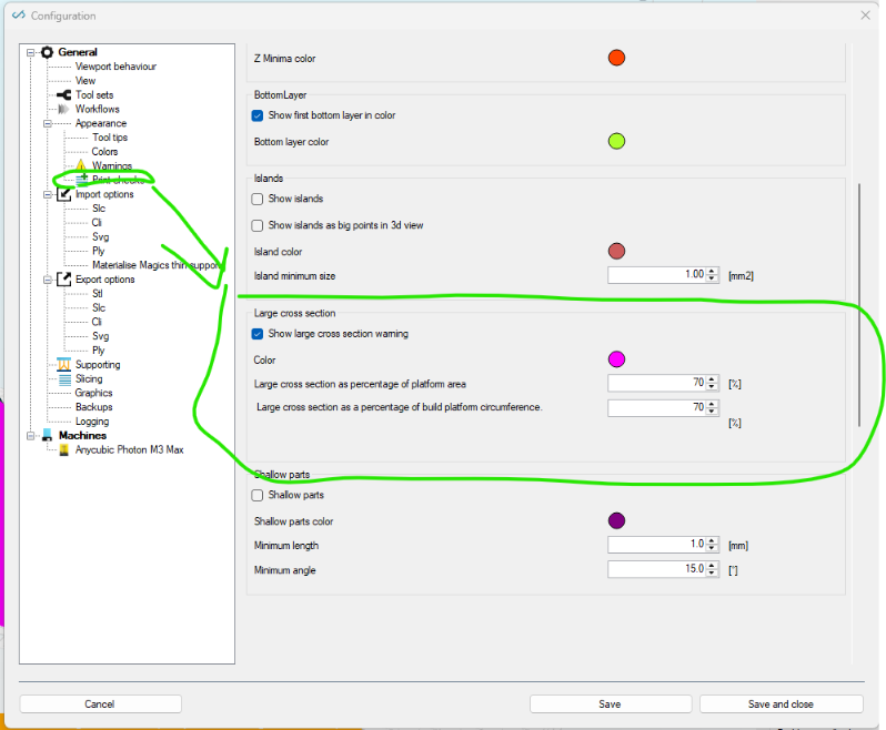

Yes that's most likely a setting for large cross sections.
You can find it under print checks in the config.
Perhaps I should turn it off by default.. as it's confusing more than it yields
