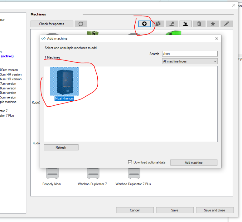

TYHI 7 Jan 20
New to the forum. Really digging the software.
Might there be a link to the online database?
I can't seem to find where it's located on the site and would love to have the Phenom Profile and see what else is on there.
Thank you!
formware 7 Jan 20
In the latest version there is a direct connection from the software to our online database.
See screenshot below; you can just click and add the phenom.
elco
TYHI 7 Jan 20
