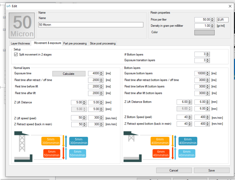

I've just uploaded V1041 to the website.
It has:
- rest time variables.
- transition layers implemented
- all height/speed variables for 2 stage movement including (imho intuitive) UI.
All variables visible in the image below are exported to the CTB SDK .ctb format.
The offtime variables are not used anymore in this case; only rest time variables.
Will be adding the other machines that are supported with this next couple of days.

Just to make things clear for me - you have two rows of two boxes for Z lift distance. Intuitively, I would think that the first row is for lift distances and the second row for retract, and the first column is for the slow section, and the second column for fast?
fcollingwood 4 Feb 22
Oh @formware, I see the graphics at the bottom - I assume this changes as the settings are tweaked? If so, that is really great, as there can be no mistaking how the printer behaves. This looks very good indeed, a lot of thought has gone into this.
The only thing I would say is maybe can you reverse the sides the lift and retract data ar on in the graphic? Currently retract is on the left and lift is the right - it would make more sense if lift was on the left and retract on the right
formware 4 Feb 22
[quote="fcollingwood, post:17, topic:903"]
Hi Frank,
- yes your intuition is right.
- The boxes on the right are fast.
- The bottom row of distances is the retract movement. CTB files have these seperate. Photon workshop files only have 1 setting to split up.. maybe this is a bit overdone on the CTB side..
- The images change when you update the values. So you see what you are doing.
I will switch the left/right of the image. You are right. Makes sense to put what's first on the left. I left out further text description as I think the view was already getting cluttered.. for a moment I thought about puting the textboxes on top over the images.. but it would make more of a mess..
Perhaps a description for the distances 'retract/peel' would make more sense that shows when you activate the two stage motion.
I'll publish an update later this afternoon. Some important bugfixes in various parts of the code base.
