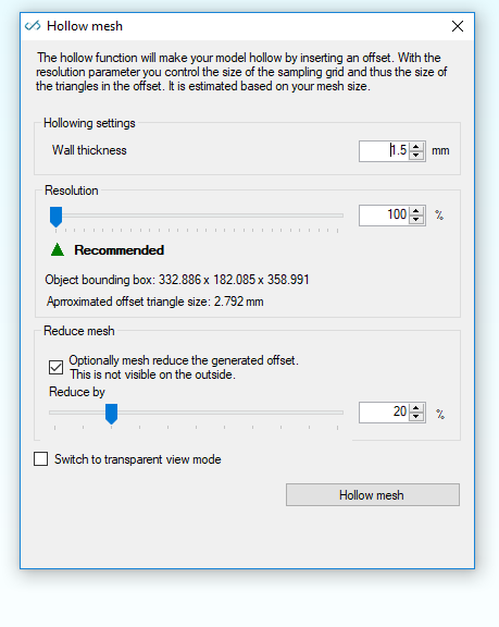

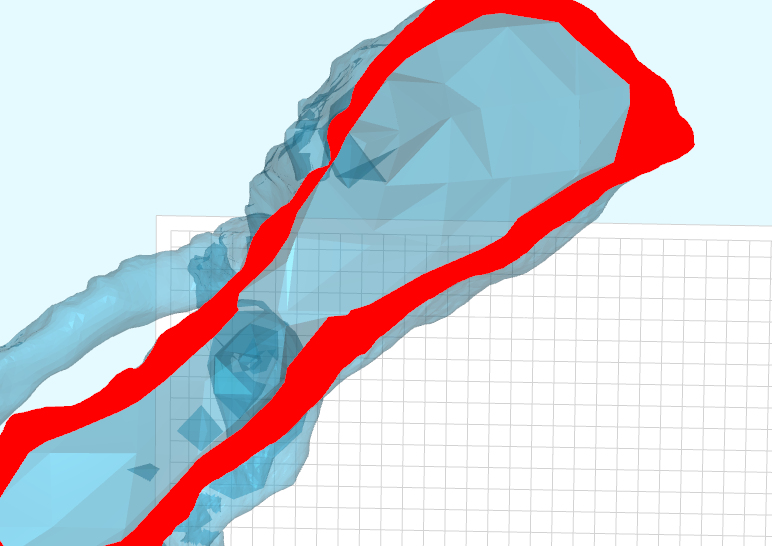

When i try to hollow objects i often encounter situations were the hollow-function creates holes or at least very thin walls which cannot be printed. This happens even if i use an accuracy of 100%.
See the following picture:
I uses the following settings:
Wallthickness 1.5mm
accuracy 100%
My plan is to print the parts as a shell with 1.5mm walls and infill.

It looks like you are also reducing the hollowed shell ? If so, this causes intersections of course.
Or otherwise using a very rough grid size? -> Where do these very large triangles come from?
It's hard to tell without seeing the actual mesh-lines or problematic mesh.

as i stated above i set the accuracy Parameter to 100% - as i understand this should reduce the grid size.
Furthermore i`m not using the feature to reduce the hollowed Shell.
Is there a different way to set the grid size - as far as i could see the gridsize is a result of the accuracy Parameter.

I've had a look and expanded the functionality with regards to hollowing.
You were right that it was not possible to hollow your model; it was to large+detailed for the current limits that i had set very conservatively to prevent out of memory exceptions.
I've expanded the bounds of that is possible within the Memory limits of a pc, calculating backwards.
Additionally The program will now give you a plausible suggestion for the resolution (better name then 'accuracy') (green arrow) based on your wall thickness that you set. Of course, you can go much higher. But computational time will increase by third power.
I was able to succesfully hollow your parts with the recommended settings within a couple of seconds.
With regards to reduction; within your specific part this will be tricky. Lots of sharp angles relative to the part size. So reduction will very fast result in thicker or thinners walls... nothing to do about it. So keep it minimal in this case.
If you wish to get a faster result; please split your part into the 2 disjoint parts that they really are and hollow seperately. It will improve the algoritms time by x2.
I've included the update in the latest installer.
