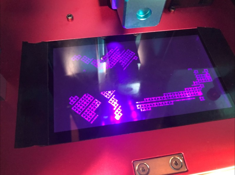

It happens that if I export to _.photon_ extension the printer does not print distorted images correctly. On the print screen. Instead on the touchscreen and in preview on PC it appears perfect (on 3 tested printers all 3 made the same identical error, precise also as distortion) [see photo 2 and 2.2].

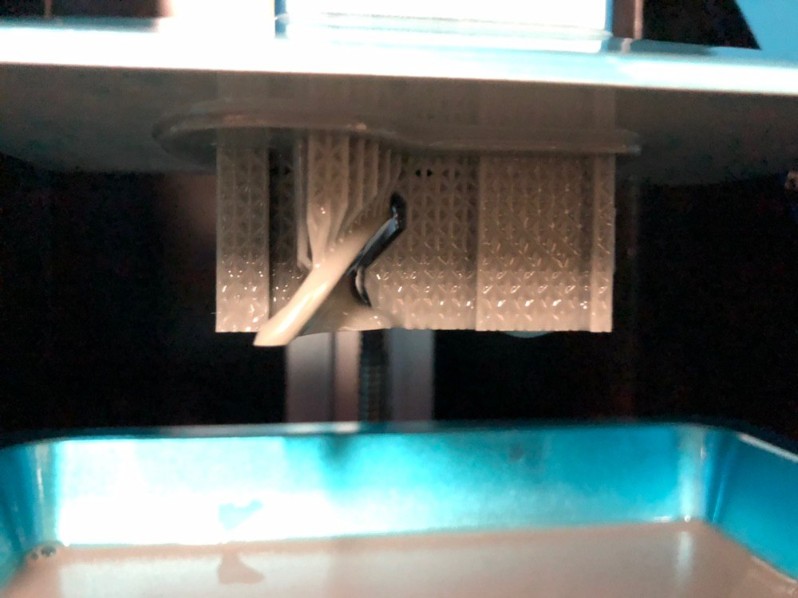

Under a friend's guide I installed Epax firmware x1 Version 4.2.15 (with AntiAlising) exporting from Formware in _.cbddlp_ extension and printing was successful as per PhotonSlicer and ChiTuBox [See photo 1].
(_1_- Photon with Epax x1 4.2.15 firmware, cbddlp slicing)
(_2_- Photon with Anycubic 4.2.12 firmware, photon slicing)
(_2.2_- Photon with Anycubic 4.2.12 firmware, photon slicing)
