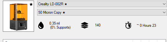

thni 30 Jul 20
Oh, and It always uses the first profile, not what I have set as Default/Favorite. I have set that it should start with the default ones. Machine works, but the Profile doesn't
formware 31 Jul 20
It should delete the file/folder. If not please add the machine as a new machine (download from our server) then it updates the settings.
