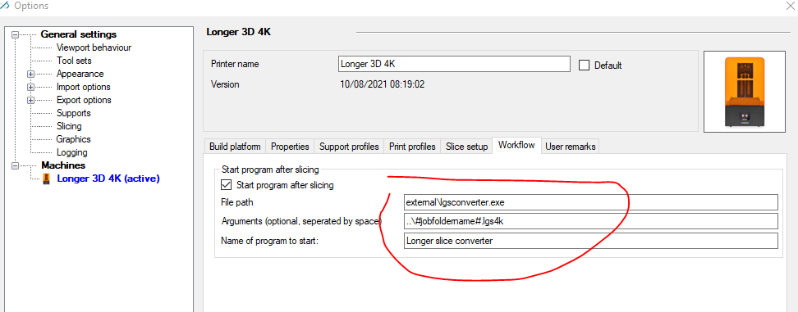

I'll write down here as well for other interested readers how it's setup and chained together.
The converter is located in the install folder: \external\lgsconverter.exe
After slicing it asks you to open the converter. This is as it's setup as an external program to start after slicing. This gets passed the jobfoldername (path) as argument.

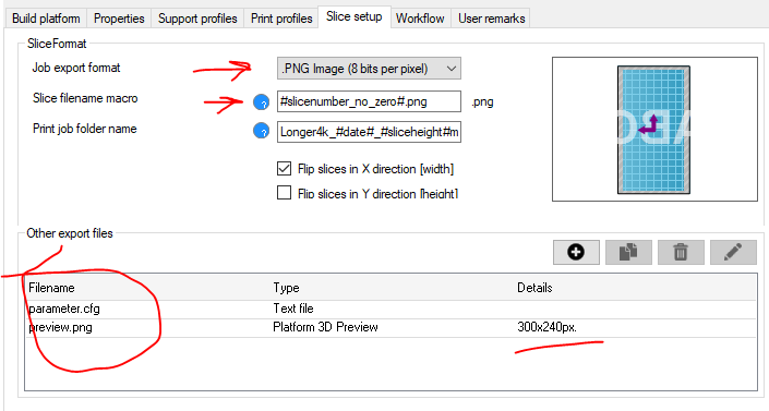

Then there's also the slice setup.
Important things are:
  1. Slice format should be 8bit PNG
  2. slicenumber_no_zero.png, so 1.png is the first slice

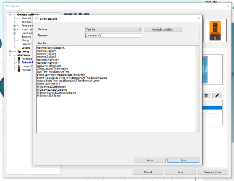

  3. the output folder then contains 2 other files. The preview.png (dimension important) and the parameter.cfg. This last file contains all parameters used for printing. They are filled in with macro's from Formware. You can inspect it in the output folder after slicing as well.

The parameters are inside the parameter.cfg file.
(double click to edit, or pencil button).

The variables are automatically filled in with the values from the software.

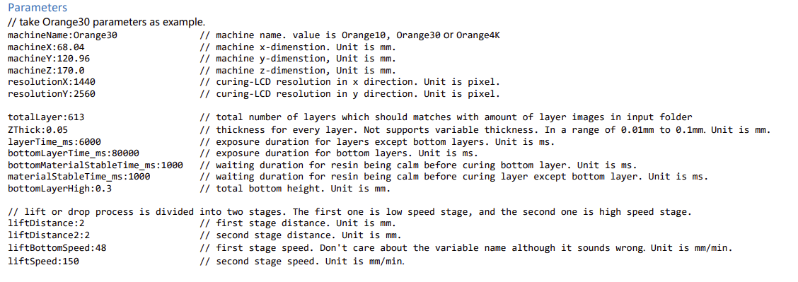

Speed is in mm/min. (just like in the software)
For what it's worth below the description of parameters in this file. .

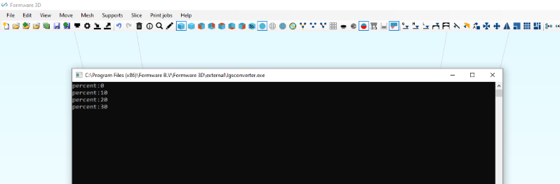

I finally came around to testing this as I am having issues with the software slicer from Longer on a particular part. I set it up on Formware, but the external program lgsconverter does not run to convert the output to the lgs4k file after slicing. the lgsconverter.exe file won't run even if a I try to launch manually. Thoughts?
formware 24 Oct 21
Are you using the latest version of our software?
The lgsconverter.exe was updated per your request. The previous one didn't output the lgs4k.
When I just try a clean install and use the Longer 4k color machine that we've setup it generates an output.
Thing is i'm not sure if that works with a mono machine. The support from Longer replied to me with a completely different answer; as if they didn't understand what i was asking. I've asked them again.

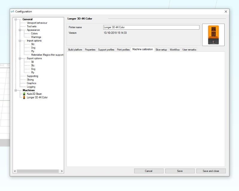

I tried a clean install but no luck. Do I need to put the slice output folder anywhere specific? Right now if just creates the folder on my windows Desktop folder. Also, why is there no option to create a mask for the printer? The options are greyed out.

What do you mean mask is grayed out? Can you provide a screenshot?

Here is the screenshot. It's not quite grayed out, but the tab is blank.
formware 24 Nov 21
ok. I'll activate it. Just re-add the machine.
By default we have many features disabled because it only leads to questions and for machines like these we are not sure if it adds anything.
if you want to have a complete machine with all functionality you can always add the 'default dlp machine'.
This will give you all options.
