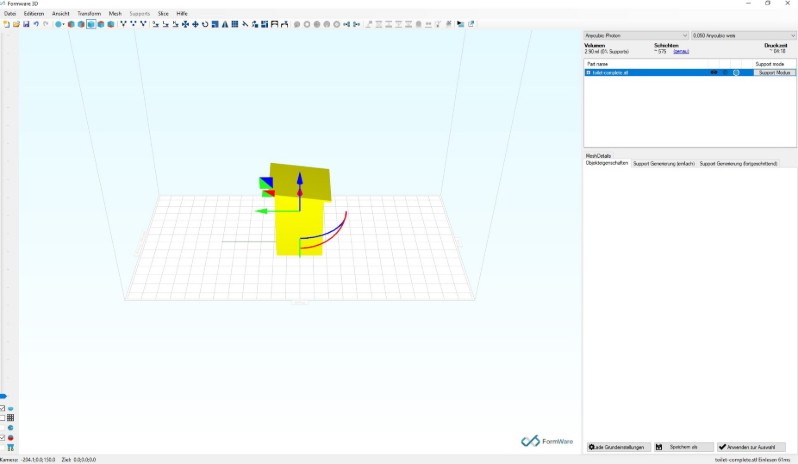

Have as an example a toilet house in the scale 1:87 loaded in the molded software.
  1. If only the model has been opened in the software, a print time of 4:18 appears.
    (This time is consistent with the actual printing time of the Anycubic Photon)

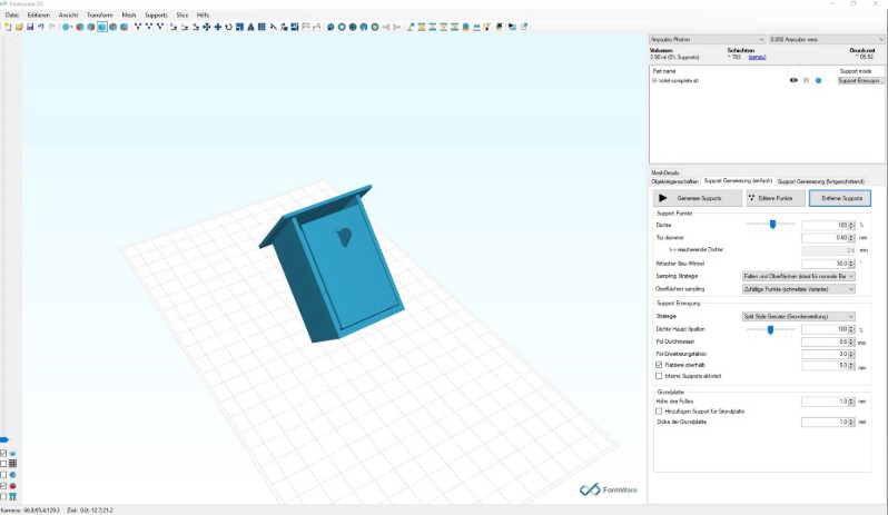

  1. Let me now leave the model "Auto-Aligning" increases the time to 5:52
    (the printing time exceeds the real printing time already 1:34)

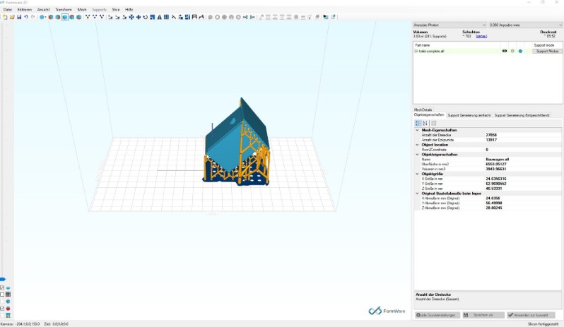

  1. If I now add support and also a base plate, then the time remains at 5:52.
Something is wrong with the calculation of the printing time, because I print the model with base plate and support, so I am on the printer a time of 4:18 displayed!

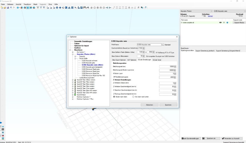

Here's my print profile of the 0.050 Anycubic white, OffTimeBetween Layers I measured with the stopwatch (between LCD On until the next LCD On)

So the 1st picture shows the print object after I loaded it into 3D Formware, without any changes.
(Now the printing time in Formware 3D is still the same as the printing time displayed by the photon)

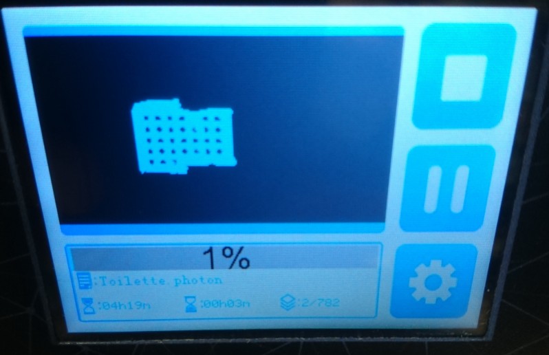

2nd picture to prove I have set the picture of the photon here with, so Formware 3D says 4:19 photon says 4:18
  1. Picture here I have the print object of Formware 3D Auto align, without support, but only align car.
    And already the printing time increases from 4:19 to 5:52 !!
4th Picture now I have also run the support mode, but printing time remains at 5:52 although the support!
  1. Picture here again the printing time of the photon, incl Auto align and support. So the print was printed by the photon with auto-alignment and support structure and needs 4:18 how so then displays Formware 3D 5:52!

The print time display in the top right of Formware 3D is 'durchschnitliche bauzeit pro schicht * number of layers'.
The first part is set in your print profile below your profile name. (see your last screenshot).
So i think the difference you see is because of this.
The software doesn't exactly know how fast your machine moves.
Lots of times that also changes per machine and print job.
So I decided to make it just 1 variable and not a calculated value.

So with the pauses times between the LCD on and the next LCD on time, called (OffTimeBetween Layers) or in Photon Slicer Off Time (s), is the time that the print bed needs between two exposure times, ie the Photon Illuminated, then it switches off, now the time is counted the construction platform rises, then lowers again as soon as the next exposure starts the time is stopped, with me almost exactly 4.8 sec. , In the Photon Slicer from Anycubic I entered this time, then the printing time of the Slicer software is the same as that of the Photon.
So I can not, as you suspected, the off-times change with it, but it is there for the off-times Enter to determine the printing time of the object more accurate, nothing else!
Have sliced ​​for several components and compared the photon slicer time with the time of the photon printer is true to 1-2 min. Assuming I wear the actual 4.8 sec. Off Time!
Since there seems to be a difference in the software variants of the printer, that is why the parameter Off Time exists.
