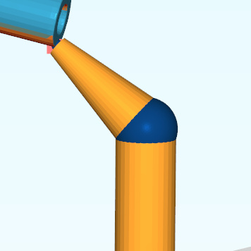

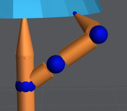

Regarding joints, something like this:
As you can see this seems to have more adjustment vs. Formware:

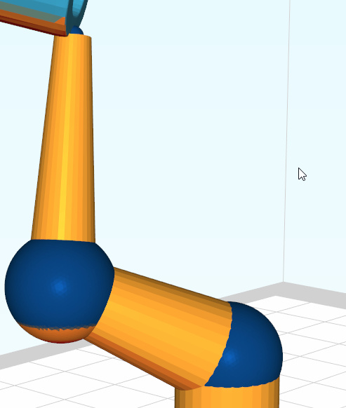

It does look like I can force something similar but it's pretty burdensome and really impacts workflow:
...done by making a connecting bar from somewhere into the post and then deleting all but the new ball joint...
formware 6 Mar 23
[quote="cepler, post:1, topic:1211"]
dual ball-joint
aaah I completely missed the word 'dual'.
Sorry about that.
I see what you mean; an extra joint.
You could for manual support also use the treesupport; i think it has 1 extra joint. But you will have 2 tips at least.
I'll put it on the feature list. thx.
