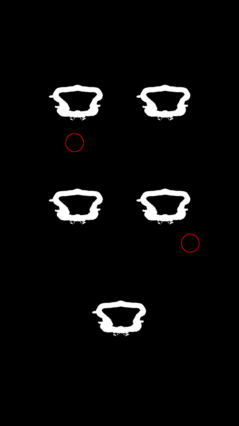

Checking some exports I noticed that formware creates various random pixels that repeat themselves for many layers.
Have a look at this image, I outlined the errors.
the pixels are even way outside the models

If you regenerate that set of slices, do you see the spots happen in exactly the same place and layer numbers?
If you move your objects in the build space and reslice, do you see the spots in different location or the same place?

the pixels start few layers from start and repeat themselves in every frame up to the end.
I just noticed them because I wanted to post-process the frames, I haven't tried yet to move or change the objects, but I don't feel comfortable using formware knowing that I could get random pixels.
I'll keep you posted

the work above included 5 times the same object, still the pixels location is very random. shouldn't the issue be the same for all 5 identical meshes?
I don't think the 3d model has horizontal holes btw, but the STL could have some issue

regarding the 5 meshes; you are partially right.
The GPU has to rasterize it to pixels. (from triangle -> filled pixels)
Dragging of the objects in the 3dview is not on a grid. So you might have different pixel layouts per object....
Still it would be interesting to see the mesh below it.

the PNG is already at 32bit.
below the random pixel there's actually something. the random pixel just touch by a whisker the surface of the model and remains stuck on the image.
the weird thing is that it happens in two different random spots and not for all the 5 meshes.
also I sliced this on a laptop so maybe the slicing happened on CPU (can you slice on the integrated card?)

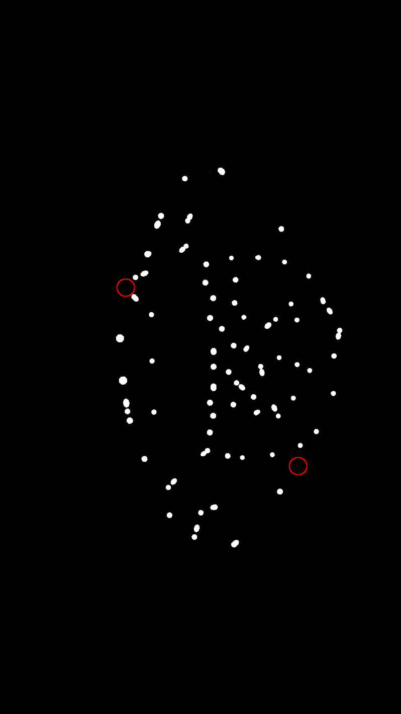

So it seems i found 2 pixels in my export; both exactly on the inner border of the bottom base plate.
When you walk through the png's in the folder with windows previewer you can see where they arise.
When i supported the model again without base plate and sliced again; i couldn't detect any pixels on the eye.
So i think the base plate could be the bad guy in this case.

I made some more tests. The problem is indeed with bases, any shape. Weird enough, by just moving the object by few mm sometimes solves the issue. this means that before printing you have to check is there are spurious pixels, if so move the object a little and reslice. viable but very annoying
