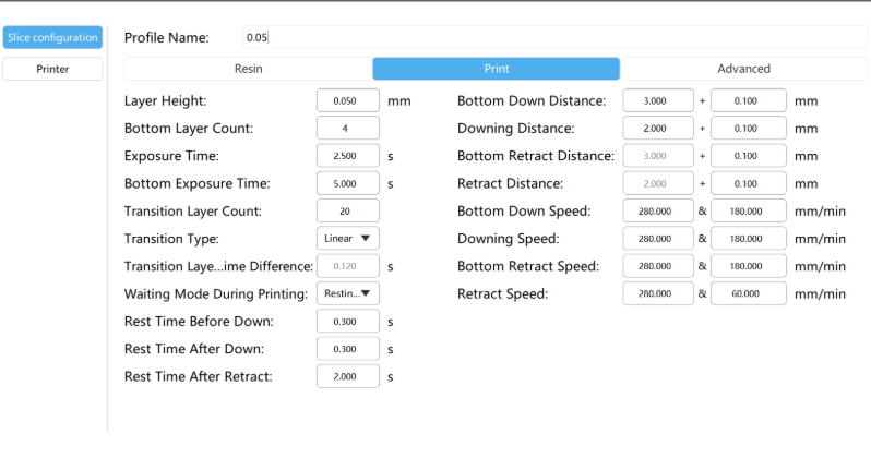

These are the options from chitubox settings
