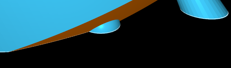

Just to expand on the issue. I've attached images which show the issue I'm running into. I adjusted my support settings to compensate for the XY reduction, but I still run into strange artifacts when viewing the sliced file.
Part with attached support:
Same plane, but showing the exposure:
There are more examples I can show, but they all seem related. The tolerance compensation calculation isn't continuous. Some other sections show more erroneous issues where the contact points are entirely missing, even though there is plenty of 'material' to still form a connection once XY tolerance is factored in.
For a sanity check, I configured Chitubox with the same support settings and tolerance compensation parameters. (I wasn't able to perfectly reproduce the beam angles and direction.) Upon viewing the sliced result, there appear to be no obvious defects.

I can't exactly see what is happening in your image.
It looks like an entire part is taken out of the model? Or is there an inner disjoint part inside?
Is the mesh error free?
You can also toggle off the black in the slice preview (icon next the job name, in the job list).
That makes is easier to see the slice on top of the part.

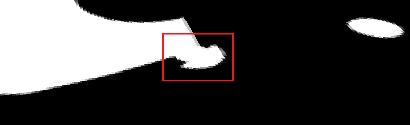

Sorry I wasn't clear about where the issue is in the attached images. The red box in the image below shows what I see when I enable XY tolerance. The support tip sphere has an irregular shape. Other areas, the tip becomes a narrow eclipse or crescent shape. I usually use a 0.5 mm tip diameter with 0.4 mm beam tip size. Enabling XY tolerance, I've increased them to 0.7 mm and 0.6 mm, respectively.

formware 6 Feb 22
Yes this is correct behaviour mathematically speaking.. it gets an offset inwards after being unioned together.
I'll have a look at how we can exclude the supports from this offset.
The reason we're doing the offset first and then the union is that the offset can generate new overlapping curves.
I guess we could just skip the XY offset on the supports. That would solves this and it would only be 1 if statement extra.

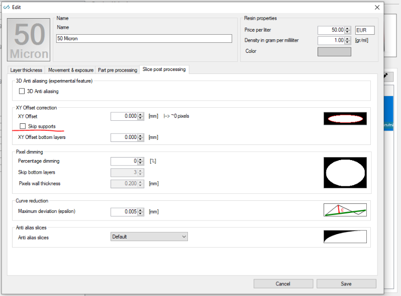

i've added the option anyway; so it will be there in next release in 1-2 weeks.

3DprinterFriend 8 Feb 22
Just wanted to say thank you for adding the option. I plan to quit testing/using pigment in my resin. The benefits don't outweigh the drawbacks.

formware 8 Feb 22
ok cool thx for that info.
I've just updated the installer on our website with a new file format.
But just realized this extra option (added last weekend) is also in there.
So if you want to play with it; it's online.
I've tested it as well in the output of course; but it's just 1 IF statement if you switch it on. . so not much could go wrong ;) ..
