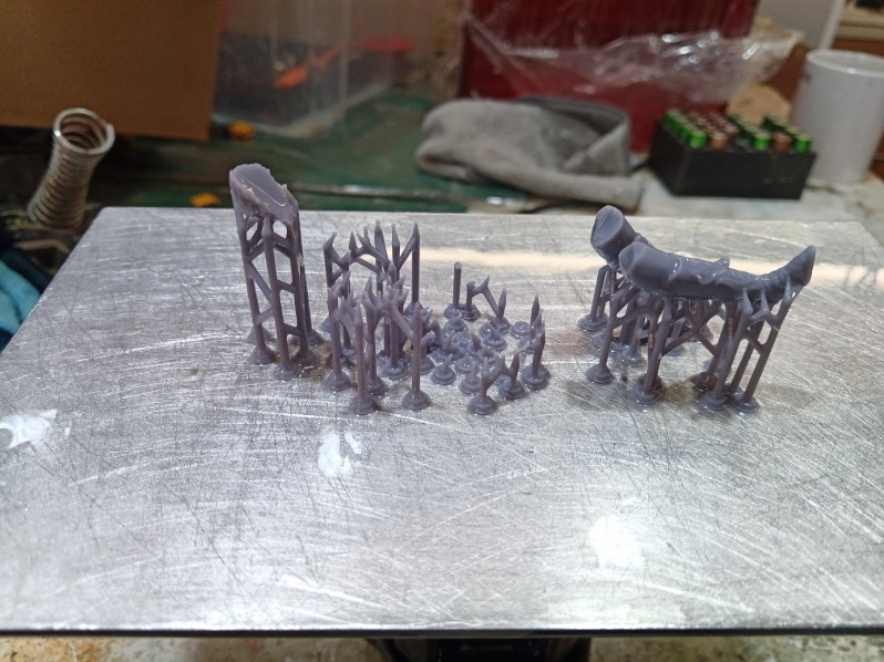

Pic of the last failure,

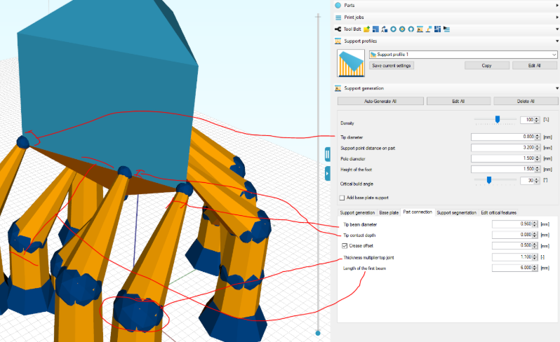

formware 10 Oct 23
Seems to be the support points where it breaks... looking at the image.
So to me it seems the force is just getting to big.
Either add more supports, or make bigger first beams.
See image below for the settings that apply there..
