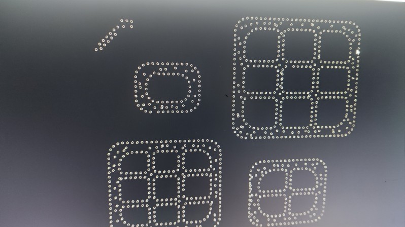

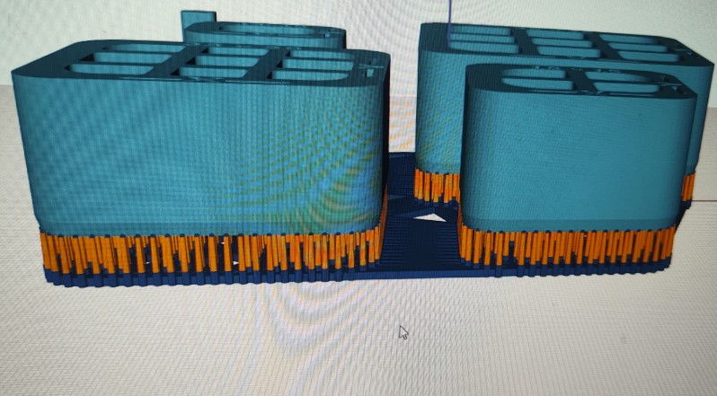

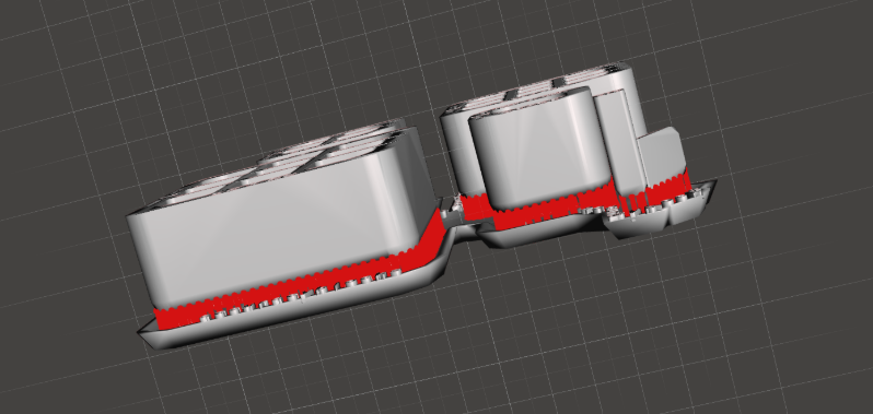

I dont know wheter its on formware or nanoddlp,the support piller is hollowed after nanodlp sliced,if I open the exported stl in meshmixer it is red on support area.
besides,I didnt slect hollowing in nanodlp profile.

I reinstall the formware it soloved
formware 30 Oct 24
hi,
Ok thanks for your feedback.
In theory; we don't output hollow columns anywhere. They are just cylinders with 8, 16, 32 sides depending on settings.
Perhaps it could be that nano-dlp makes a slice error when there are 2 columns on exactly the same place? But i don't think so.
Happy to hear it's solved.
