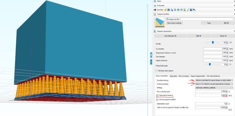

Is it possible to add supports under a model with a flat surface?
I have files with a flat base, but I'd like them to be on supports (like on chitubox).
I can't figure out what to do if, for example, I have a cube placed on one side. How can I automatically place supports on ALL the side parallel to the platter, without placing them on the edges of the cube?

Like this?

Yes I hadn't tried to change the surface sampling, it was that !
In addition, the value for the tip and diameter of the post was too high (I had used the same parameters as chitubox).
