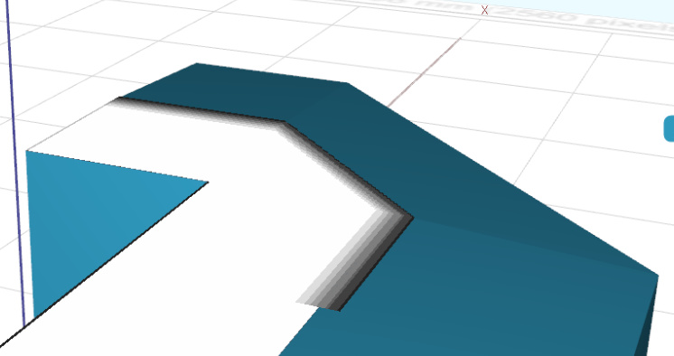

Just a short update on this topic. We've implemented an algoritm that works smoothly numerically.
Algoritm is verified in the 3d viewer visually in all directions with overlaying the printjob output.
Also the slicing time is acceptable. Still pretty fast for a 2k screen. Non optimized.
I've attached some image below.

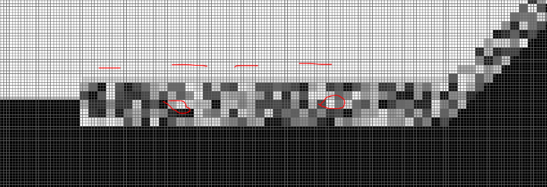

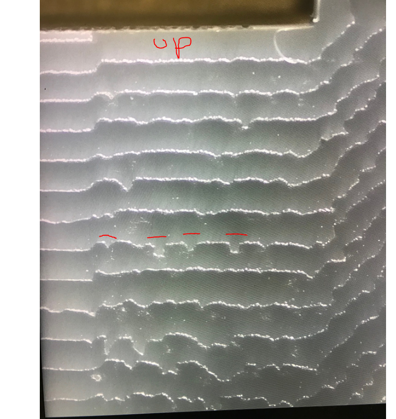

1:16 surface angle:

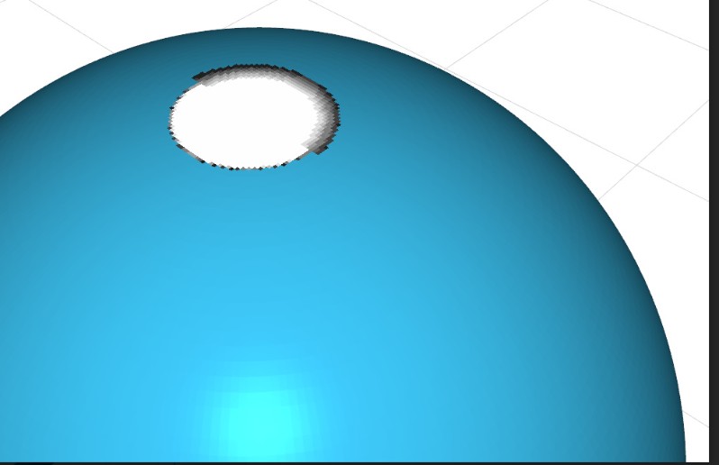

sphere top:
dittering applied instead of AA in Z direction

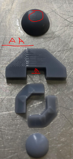

Print result. Left half of the table is Z antialiased.
You see a very little different in light over the stair steps. Marked red.

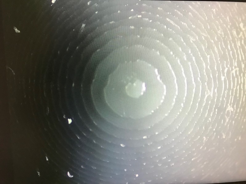

First a microscope image of the Creality's LCD screen when turned on:
Most probably this is not a Mono screen, but a regular RGB screen with a certain blue filter.
Only blue pixels are used. It's clear there is a large distance between each pixel.

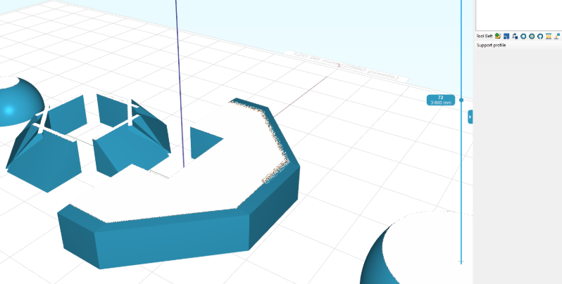

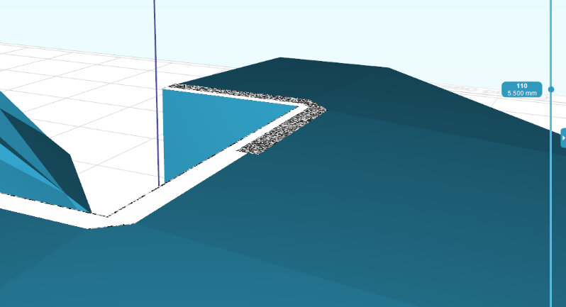

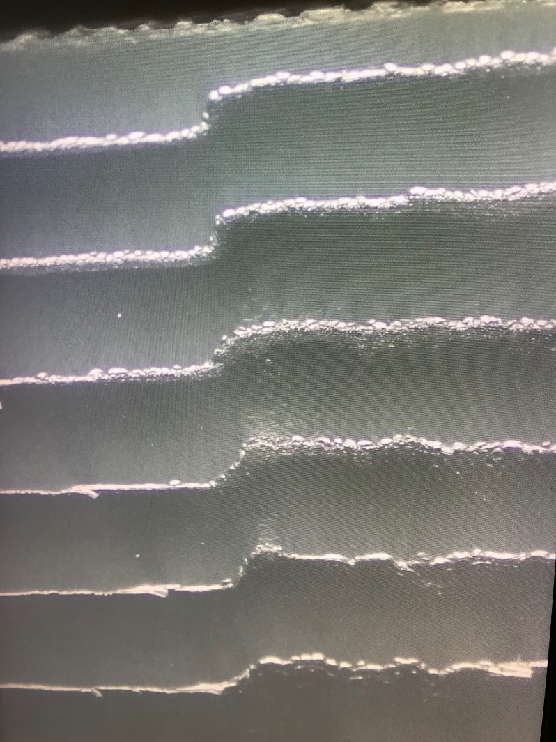

Then the test print in close on a 1:16 slope with the slices overlayed and 100% noise applied on the anti aliased levels:
This is the slice in topview:
And this is a microscopic view of the actual top layer.
Conclusions:
(valid for low end LCD printers with regular RGB screens)
  • You can clearly see that exposing individual gray scaled pixels has no influence in Z direction. The layer border is just moved back entirely by the part that contains the noise. No noise pixels are printed correcly
  • Anti aliased pixels on the XY edges work. The upper part of the photo shows the upper vertical border. You can clearly see the noise effect there. Makes kind of sense; XY anti aliasing has an effect. Z anti alasing alone doesnt, the pixels don't solidify.

Last a nice picture of the top of the sphere. Top half of the image is with noise on the Z AA pixels.
