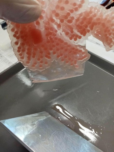

Since last week we started getting a very thin film that extended from the base layers towards the edges of the buildplate on our Anycubic Mono X.

A wild idea, but it almost seems that, for some reason , the black is not 100% black anymore and lets a small amount of UV light slip through, resulting in a thin film.
I'll upload a picture of that thin film later...

I did upload a picture in my old post, if you want to see what i'm talking about.
