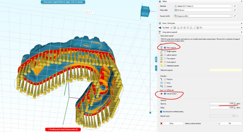

Hey gus, i need vertical support, its not possible to do with this config of support. i need a better configuration.
check AnycubicPhotonWorkshop the design its better of buttons and input but i understend that its not the point of formware and its ok. Andcheck configuration supports. I cant enable and disable a type of support. like disable tree... or tree ramification numbers... those things its important, i ll get my anycubic p1 and i dont want stop use formware

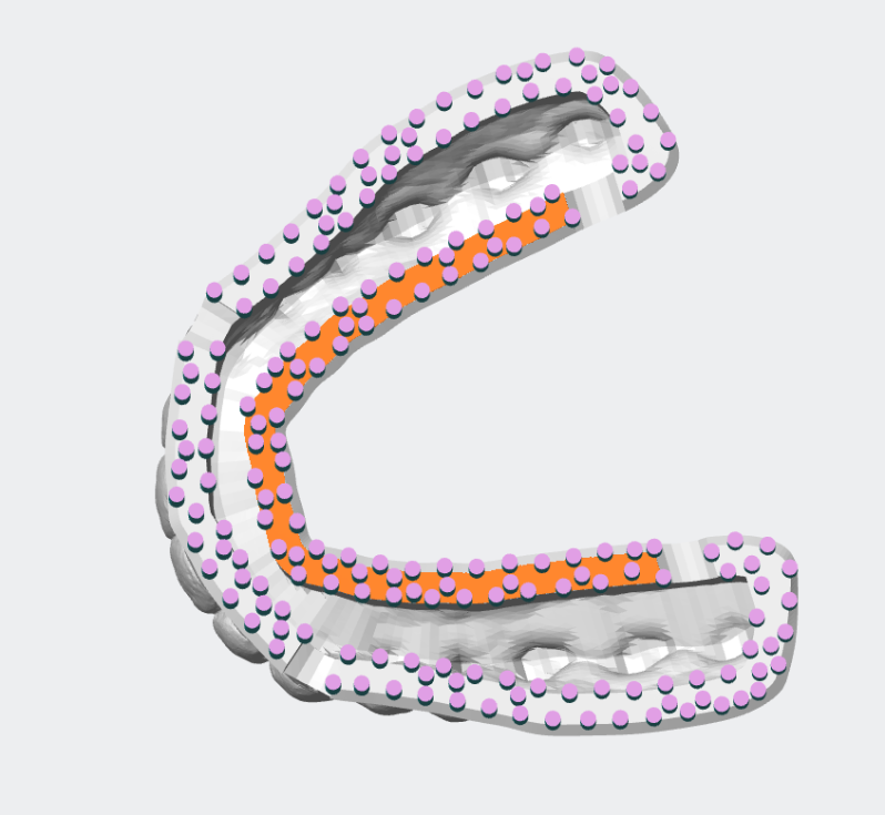

SMART FILL just mark the are check that and a way to do

Hi Jose,
Check the 'basic support' + 'critical surface' in the array support tool.
You can do this with 2-3 clicks.
formware 9 Jan 26
it needs a couple of seconds to calculate if you increase the density; can be made a bit quicker in the future but it works.
