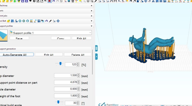

Something has caused the auto generate support to take much longer to complete.
Support profile 1.
Density is 101% should it be this high?

DaveH 1 Oct 24
After the upgrade, 104% took over 5 mins to complete, the supports were a solid mass. I reduced density to 5% and auto-generated, then back to 123%, this seems to have corrected the problem.
