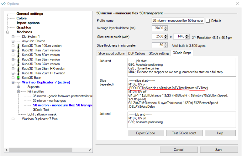

I realize that this answer is probably too late to be useful for you, but it might help someone in the future. You can already sort of do it, albeit in a very hacky way.
Open File > Configuration > expand Machines > expand the machine profile you use > expand Print Profiles > open the printing profile you would like to try this with > open the GCode Script tab. Have a look at the highlighted line in the textbox. Your profile should have a similar line:
It says
> ;PROJECT($SliceNr < $BtmLyrs?$ExTimeBottom:$ExTime)
The important part is
Here it checks whether the currently printing slice number (__$SliceNr__) is smaller than the configured number of bottom layers (__$BtmLayrs__). If that's the case it projects the image for __$ExTimeBottom__ milliseconds (the bottom exposure time). If not, it will expose the layer for the normal exposure time in milliseconds (__$ExTime__). Click the help button you can see in the lower right to get more information. As a side-note: The first layer gets $SliceNr 0, the next one gets 1 and so on.

So to get to the point, you can nest these conditions. Take the following line of code:
> $SliceNr < 10 ?($SliceNr < 5?30000:20000):10000
What the code does is this: It checks whether the current slice number __$SliceNr__ is smaller than 10. If that's __not__ the case (i.e. upwards from, and including, slice 10), it skips the bold part and comes out as 10000. So from layer 10 on it will expose for 10 seconds. But for layers smaller than 10 the bold part is executed:
That's again just a check for the current slice number. If it's smaller than 5 the layer time will be 30000, but if it's 5 or above it comes out as 20000. So if we generate test gcode it will come out as something like this:

If you create your own expression, watch out for any spaces between PROJECT and the time. You can test your GCode with the "Export GCode" button. So, what if you wanted more granular settings? Well, you can go for as many of those nested expressions as you'd like. For example, to have 5 different setpoints you could use the following GCode:
> ;PROJECT($SliceNr < 100?($SliceNr < 75?($SliceNr < 50?($SliceNr<25?50000:40000):30000):20000):10000)

This solution has a little problem though: Replacing the existing line of GCode with mine will render the Number of bottom layers, Bottom exposure and Exposure time settings in the configuration dialog useless and may mess with print time estimations. To get around this (not sure how the print time is calculated. Does anyone from the team mind chiming in?) you could use the variables and do something like the following:
> ;PROJECT($SliceNr < $BtmLyrs?($SliceNr < ($BtmLyrs/2)?$ExTimeBottom:(($ExTimeBottom-$ExTime)/2)+$ExTime):$ExTime)
