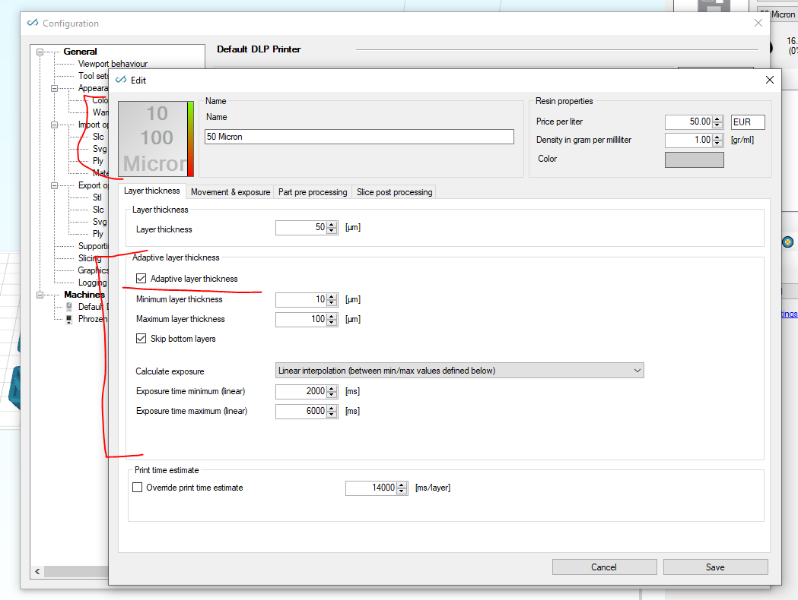

formware 11 Feb 22
Yes. It's released since V1040, with some bug fixes and improvements in V1042.
It's documented in the documentation as well.
But i'll summarize it here for the ones interested.
You can activate it per print profile in the config:
Settings are documented and i think most are self explanatory.
For the exposure time there are 3 settings.
  1. fix all to same value (default exposure value from movement tab)
  2. linear interpolate between 2 given values
  3. use exponential calculation (you need to know your machine for this and exact resin specs.)

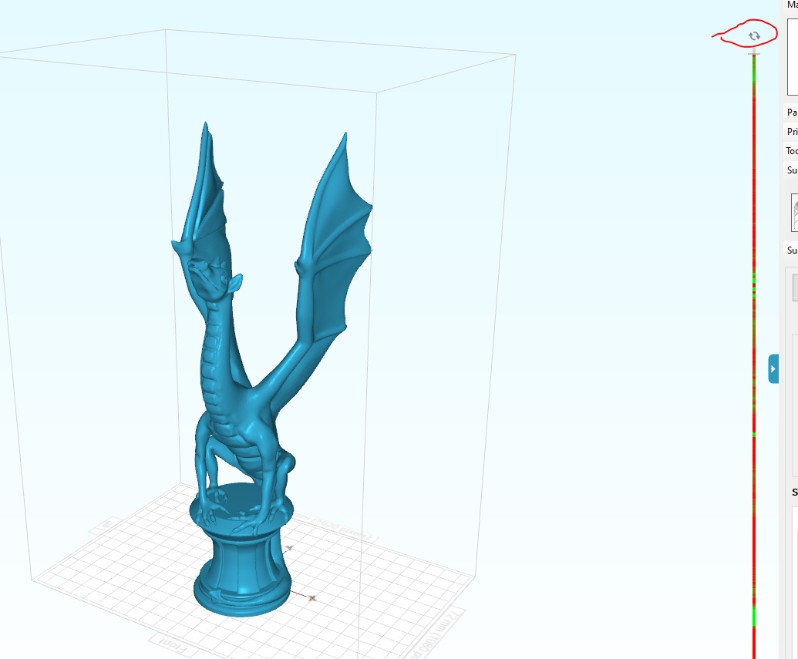

In the 3d view you will receive a small refresh icon on top of the slice bar.
Upon selecting a profile with adaptive strategy it will update once. After that you have to manually do it as it would be to annoying otherwise. Before slicing it automatically updates it.
I still have to add some functionality to manually fix a number of slices to a fixed height.
It works for every type of export and every file format it was able to write a layer height/exposure into the layer info. Whether it works on specific file formats i have my doubts and it's to be tested. According to CTB it should work on the CTB SDK exported format if the machine has the latest firmware. I think also on photonworkshop files it should be possible to use it with the latest firmware.
For machines using gcode it should of course be no problem. It gets exported in the gcode.
