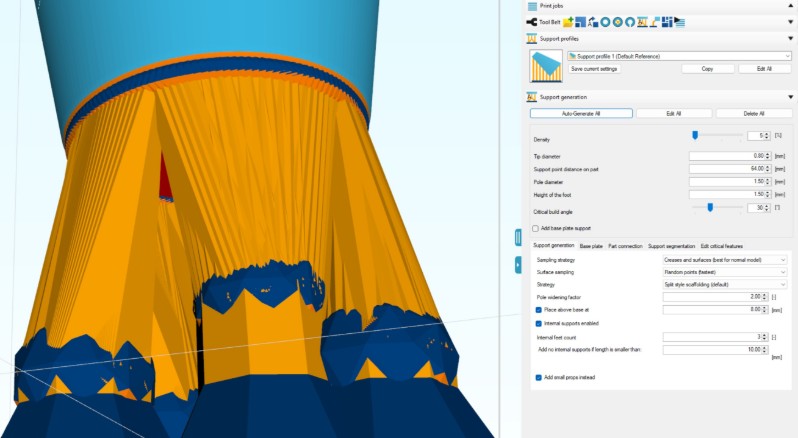

Hi Elco, I updated to ver:1220 and the automatic support feature seems broken. regardless the settings (talking a bout supports density) the software places hundreds of overlapped supports. see the image:
j
jefree 20 Dec 24
Same here. Whatever I try, it ends up using TONS of overlapping supports
formware 23 Dec 24
From the picture this seems an edge case I still need to fix.
We had some feedback (months ago) that critical minima should never be removed from supports. Never filtered.
So i took that filter out.. but it seems a critical minima is not an edge point where 1 side of the adjacent face is flat. I need to change that defintion..

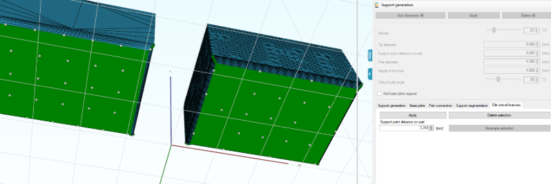

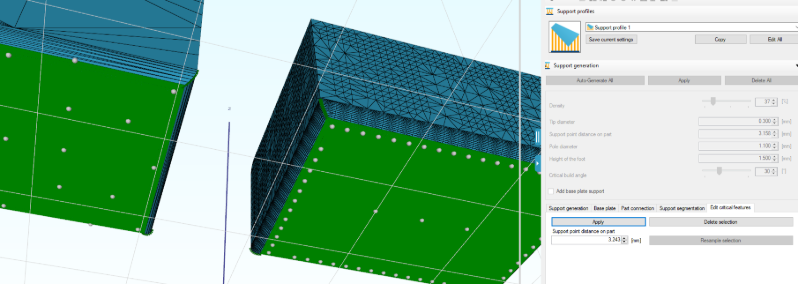

formware 23 Dec 24
I've pushed V1221 to the live system.
I think this would solve the issue shown here.
old:
new:
(no more points generated on the edge because they were defined as critical minima..
this was not noticed by all users, as when the fillet was not there, it would create an edge and filter out these double generated points)
