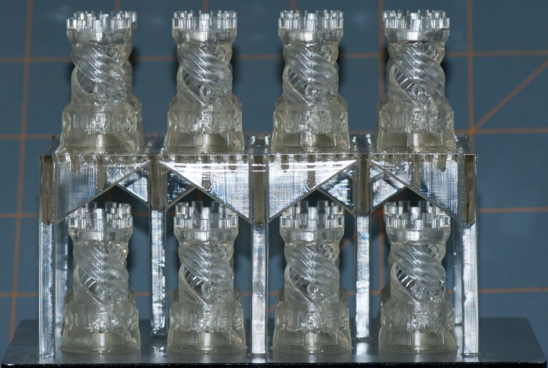

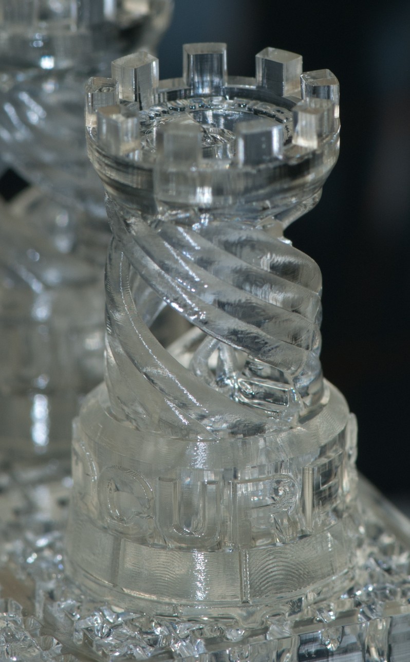

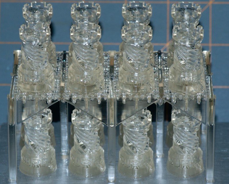

Here is a small sample of the table feature in Formware 3D.
I really like this feature as it expands your print bed in the Z axis allowing many more parts to be printed at one time.
I have successfully gone up to four layers high.
Parts were printed at 50um layer height using a mask to even out the UV light across the entire print bed. The rook was downloaded from the Monocure website.
