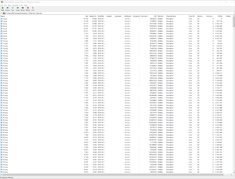

wkomassa 21 Feb 19
Thanks very much. Yes, I think you are correct. The .Zip structure is like this:
Individual Slice is just <slice number>.png (8-bit)
Two preview images:
"preview.png," Full-size preview is dependent on the size of the parts being printed, but is more or less in-line with the projection size
"preview_cropping.png" is also dependent on the size of the parts, but I believe the max size is 640x480.
Gcode file is named "run.gcode"

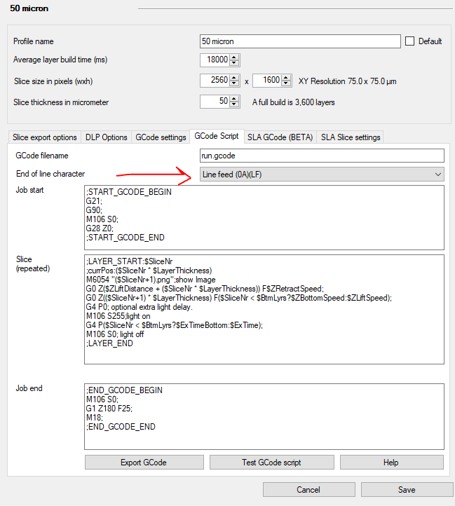

formware 22 Feb 19
Hi Will,
Thanks for this info. It would translate to:
;START_GCODE_BEGIN
G21;
G90;
M106 S0;
G28 Z0;
;START_GCODE_END
;LAYER_START:$SliceNr
;currPos:($SliceNr * $LayerThickness)
M6054 "($SliceNr).png";show Image
G0 Z($ZLiftDistance + ($SliceNr * $LayerThickness)) F$ZRetractSpeed;
G0 Z(($SliceNr+1) * $LayerThickness) F($SliceNr < $BtmLyrs?$ZBottomSpeed:$ZLiftSpeed);
G4 P0; optional extra light delay.
M106 S255;light on
G4 P($SliceNr < $BtmLyrs?$ExTimeBottom:$ExTime);
M106 S0; light off
;LAYER_END
;END_GCODE_BEGIN
M106 S0;
G1 Z180 F25;
M18;
;END_GCODE_END
I will create some extra options now to handle the different file naming conventions. Guess we need some more flexibility there anyway...
formware 22 Feb 19
Hi Will,
I've published a version that has the machine in it.
Would be great if you could have a test with it to let me know if it reads the generated GCode and PNG's ok.
I had to modify some items: ..
- 2 previews can be exported now with custom names
- name of gcode file can be set
guess this makes it a bit more flexible now..

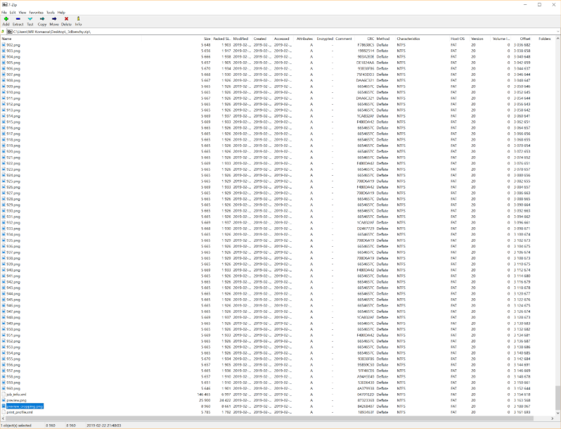

wkomassa 23 Feb 19
Thank you so much! Alas, it still doesn't work. When attempting to load the file on the D8, the progress wheel just spins for a few seconds, then fails without an error message.
I did some comparison and testing between a known working slice package of the identical model (and print settings) generated with ChiTuBox 1.3.0.
The only differences I could see in the files themselves were in some spacing and comments in the gcode files, and the preview .png files. I modified the spacing in the gcode file, manually added the comments, removed the additional .xml files from the Formware .zip, and replaced the images in the Formware created file with those from the ChiTuBox file, and it still fails.
The only OTHER difference I see is in the file permissions and Host OS descriptors in the .zip files. ChiTuBox reports host OS as Unix and applies Unix permissions, among other things. I've attached two screenshots of the zip files so you can see what i'm talking about, as well as a link to the .zip files themselves, here: https://www.dropbox.com/sh/ouybap2qzuqe98g/AABa-0PzKP7n98SqJWG7ea4qa?dl=0
Hopefully that helps. Thanks again!
Will

formware 24 Feb 19
found another thing... the previews from chitubox are 24bit instead of 32bit png's.... given that the previous wanhao d7 systems also seemed picky about bitness of png's that might also influence it maybe..
formware 24 Feb 19
but if you exchange them and it still doesn't work that shouldn't matter...
what if you exchange the GCode file only? does it work then? that would immediately rule out any other things... would be good to know to fix further....

formware 25 Feb 19
ok. So it's in the GCode.. i'll try change the line ending char in a variable in the afternoon..
formware 25 Feb 19
Hi will,
I've uploaded a version to our website that lets you choose the end of line character.
I've defaulted it for the D8 to only Linefeed (that's what it was in the comparable file)
Hope this fixes the issue..
otherwise i have to copy the entire header... don't hope so..
