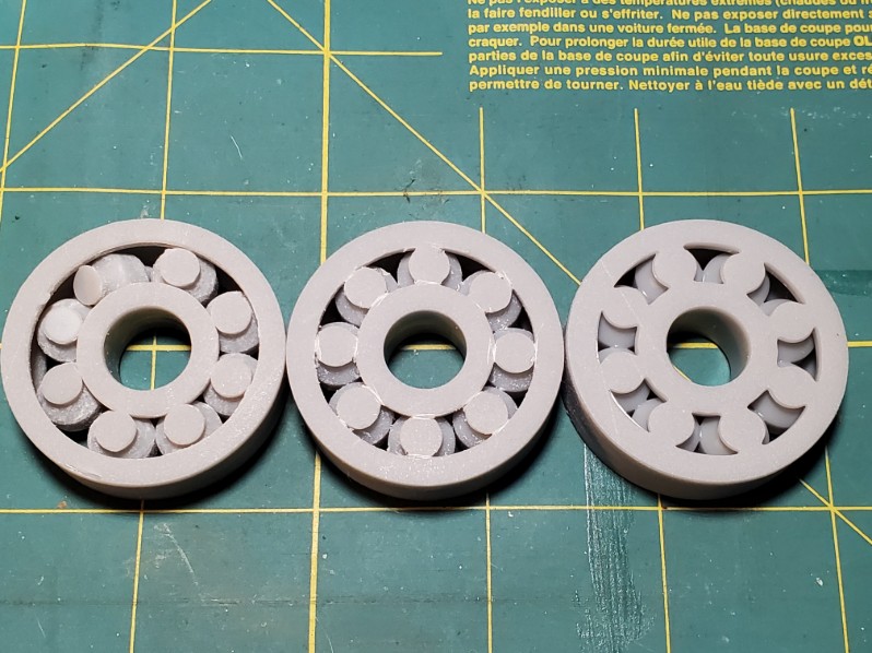

I made a working resin bearing.
n
nuroo 26 Nov 20
Print in place bearing.
Needed to cancel the bottom layer expansion. (1 range)
Needed to slightly increase distances between internal surfaces on the upper parts of bearing at a different correction amount. Bearing will be sloppy/to loose if the same correction range is used for whole bearing. (a different range of correction)

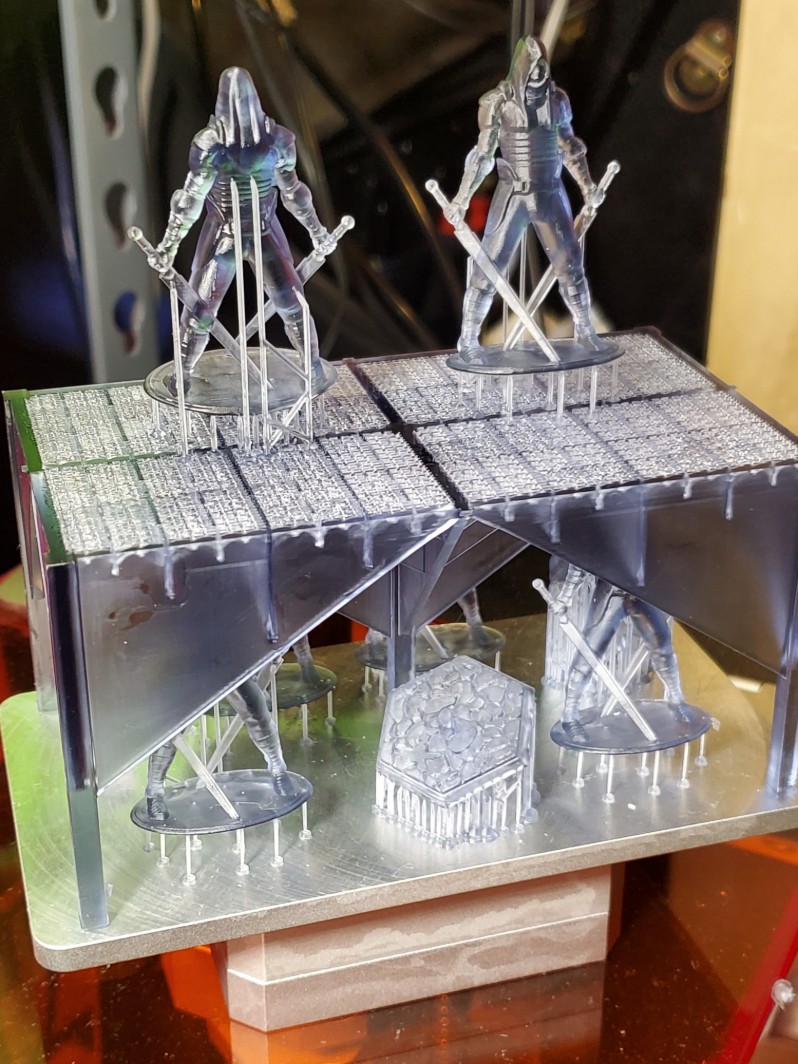

I once used the formware trial in combination with chitubox for this print. It showed a feature formware had other slicers don't have. Made a facebook post about it.

Nice print! Off topic, but honestly what impresses me most is that you have so few supports under the base of those figures, but they appear to print fine. The platform thing is awesome too of course!
Back on topic, I'd definitely use some of these features, which of course would require lots of dialing in. I find myself dialing in nearly every new bottle of resin, so simplified testing measures would be great.
formware 7 Dec 20
@nuroo that's a great looking print! Indeed very little support.

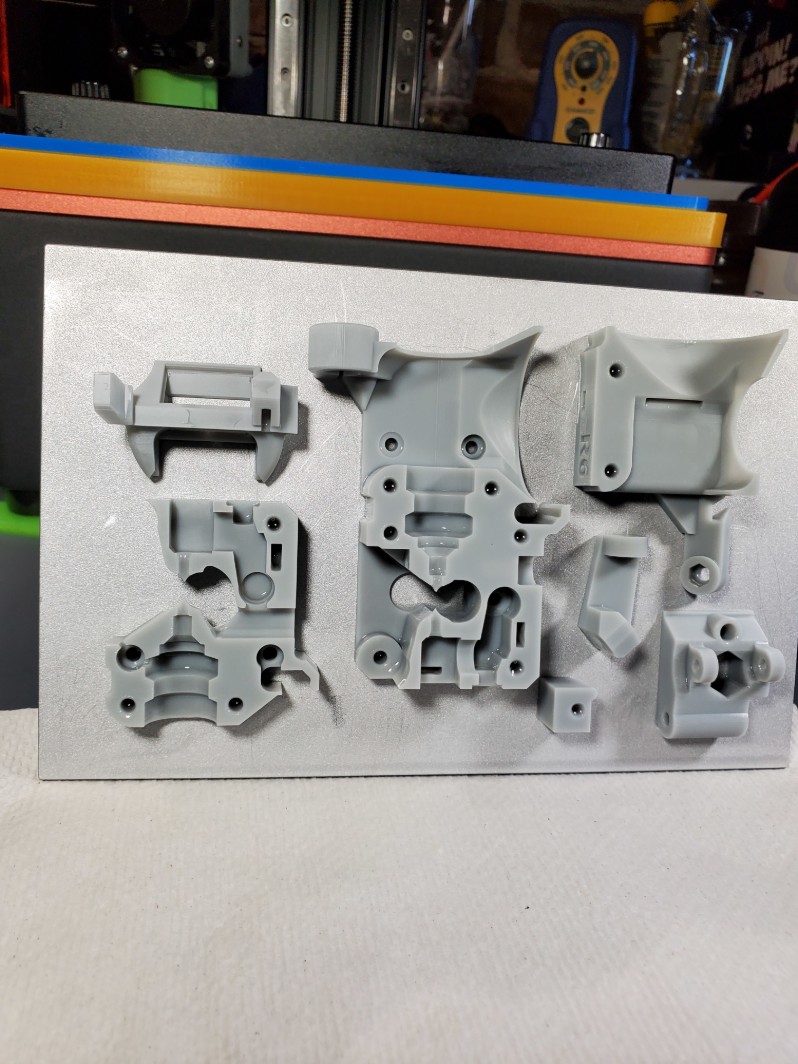

Practical use....... Upgrade MK3S+ parts printed directly on build plate - no bottom layer distortion.
