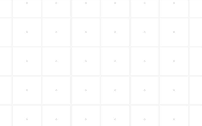

If you know of a resin printer that gives full gcode control I would be very interested. It seems to be a difficult spec to find. I assume the Chitubox units do not because the LD-006 seems to be hard coded to do a full lift every time an exposure is done.
I can't use the built-in Formware3d method because the LD-006 light array means I need a mask something like this:
I'm still tuning that.

Yeah.. much has been asked and written about this mask wizzard..
I think for the older machines like the LD006 etc. it makes sense to apply a mask. The intensity can vary with 50% towards corners. Later machines are more and more equal in UV intensity over the platform.
