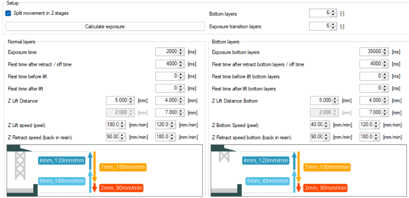

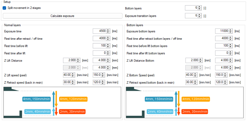

Just realised I can paste in here, so if it helps:
Default profile that works fine:
Modified profile that goes too low:
