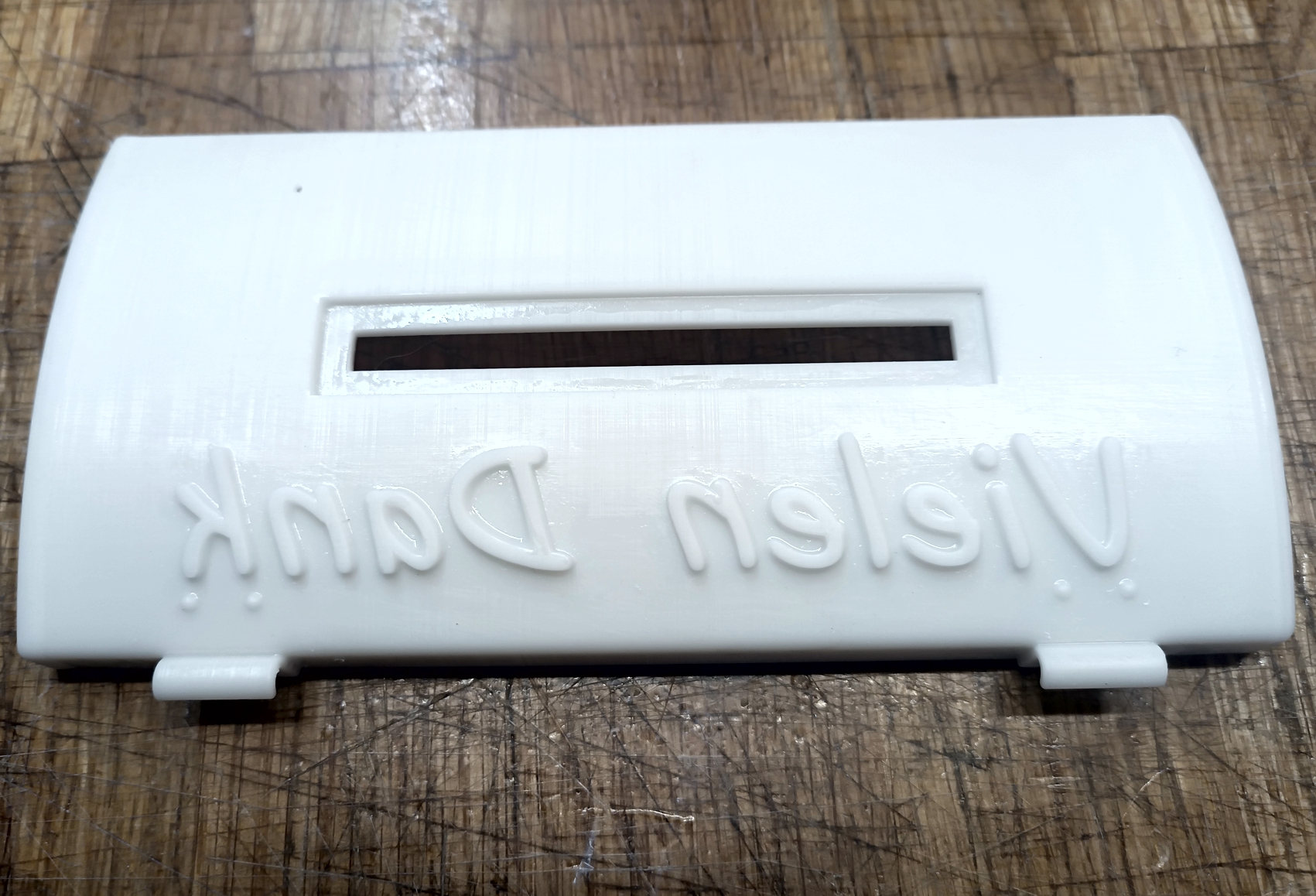

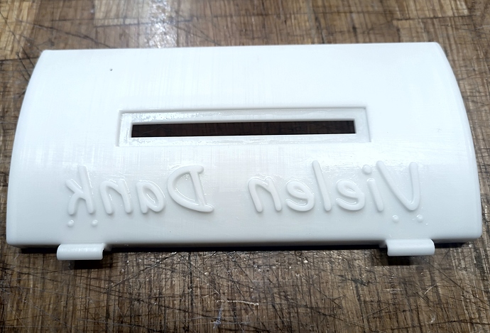

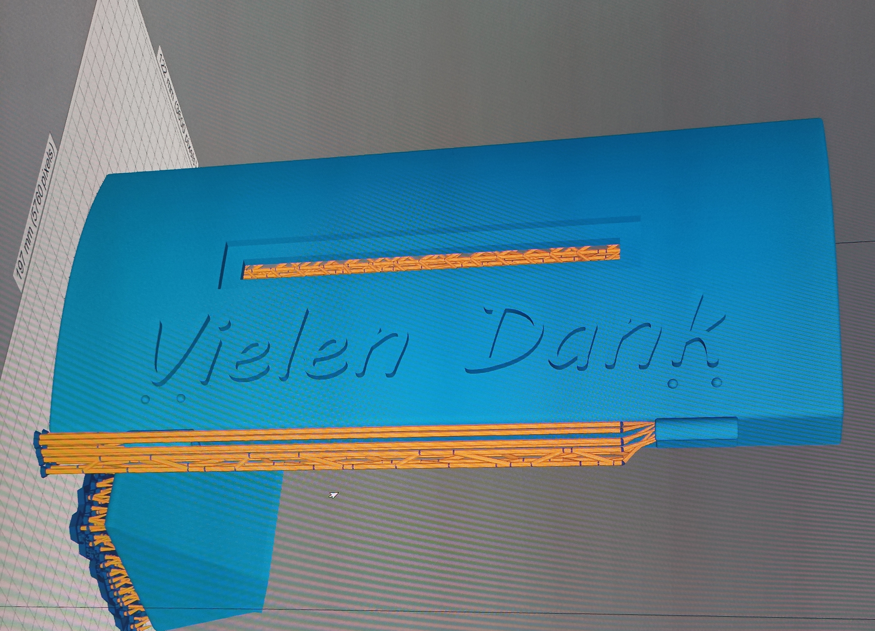

Hi, I have the same problem with my Elegoo Saturn Printer. In the slicer Software all is correct, the x/Y boxes for mirror are not on and the sesult is a mirror print. If I slice it it for my ANYCUBIC M3plus all is correct. There might be a error in the Elegoo slice files.

Hi Bruno ,
Thanks for the info. Just check either one of the boxes and the problem should be gone.
I’ll update the database as well for this machine.
