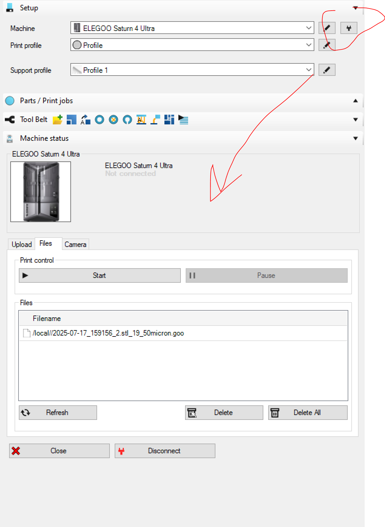

Hi i intent to buy the software. i liked that i can use in lot of printers and the support its serious. so that help me… I am having problem to FIND and CONNECT with my Saturn 4 ULTRA my ip is 192.168.15.2… i only can upload for my lucky manualy adding the ip… can you please fix that… I Had some problems with slower printspeed and adesion of support in some parts of the print a bit strange…

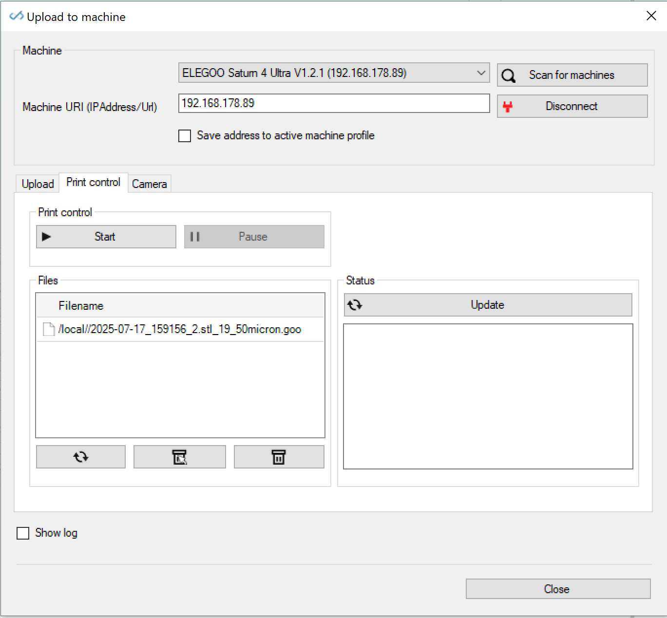

#4
Dont work, and i cant list files. can i have you whatsapp or discorg group so we can talk.
#5
the only thing i can do its upload. only upload.
#6
Hi Jose,
Ok. And the uploaded file it does work?

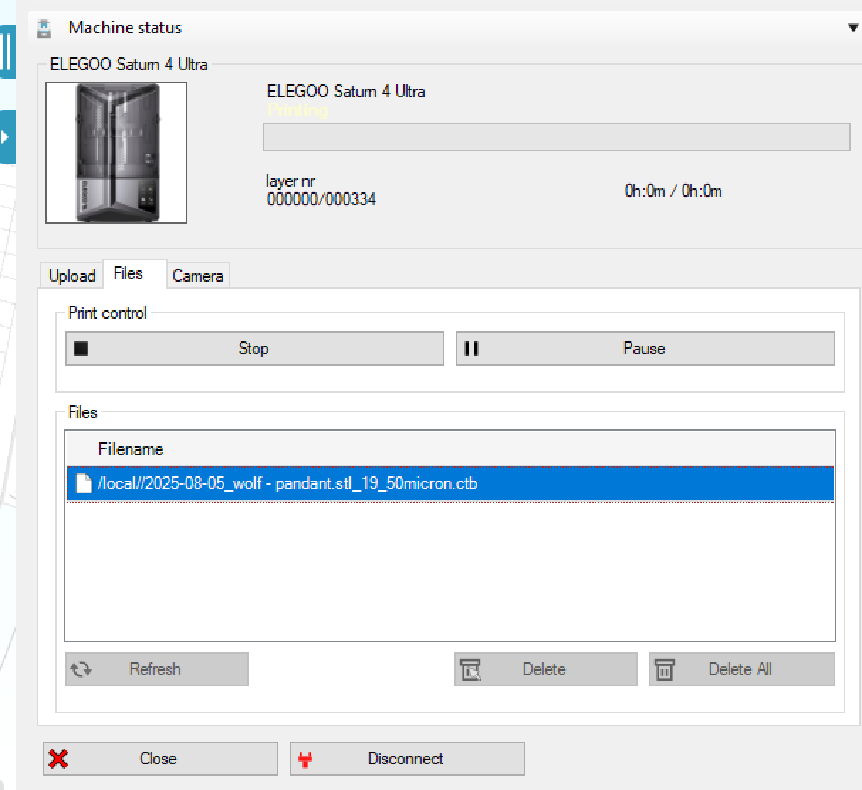

We’ve received our saturn 4 ultra. But it looks to me like it’s working as our previous printer based on this hardware.
the machine is found when connected in the same wifi network as the pc.
You can upload; view files and start a print.
Also the camera works if you turn it on.
The screenshot below is from slice->upload to printer.
But you can also click the connect icon next to the printer selection; then it will show you the machine status tool. (last screenshot below).
When you find the printer; then you just click ‘connect’. It should look for and find the printer automatically. But truth be told; the UDP protocol, that is used for this, has a lot of downsides.
can you share some screenshots of what you find?

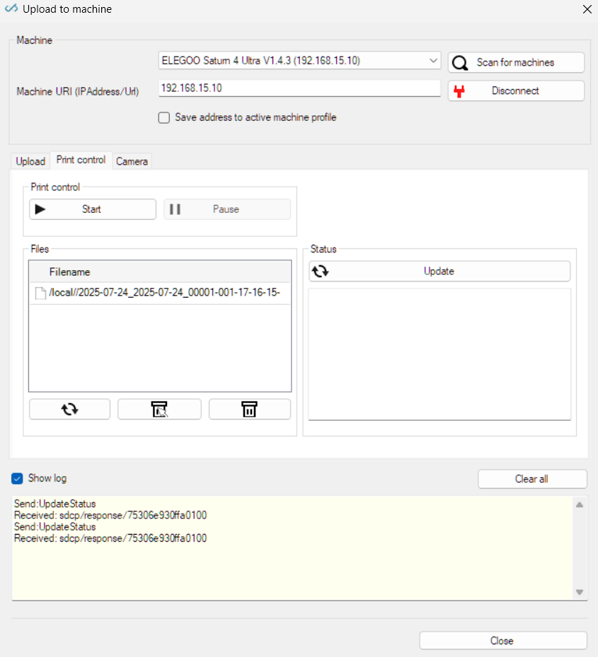

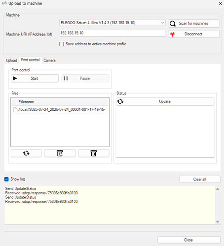

#13
try update your printer. my ip its 192.168.15.100 15 may be a problem ?

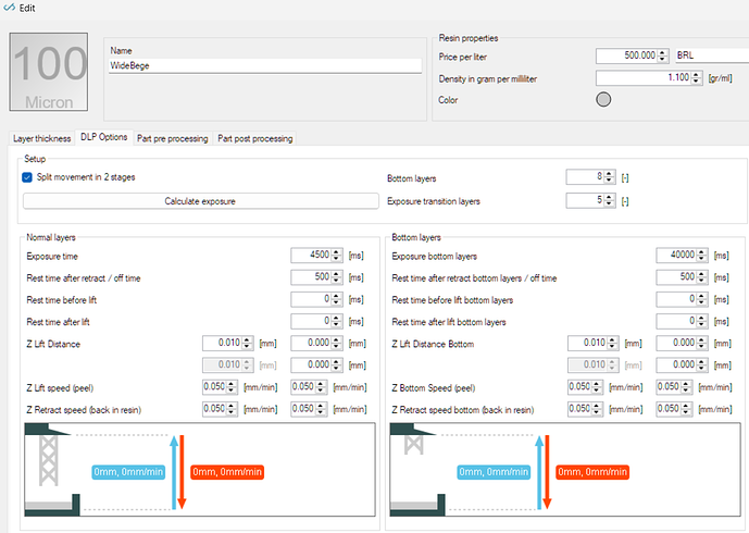

Subject: Partial Success After Update – Need Option to Disable Z-Lift on Saturn 4 Ultra + Print/Status Issues
Dear FW3D FLYSER Support Team,
After updating my printer with the latest firmware, I encountered several issues. That said, I recently managed to complete a successful print with optimized speed settings — the job took around 40 minutes.
However, there are still key problems preventing consistent and reliable use of the software:
  1. Z-Lift cannot be disabled – On the Saturn 4 Ultra, Z-lift is not required due to its hardware design. However, FW3D FLYSER does not allow me to fully disable the Z-lift between layers. Even setting it to the minimum value (0.010 mm) still introduces unwanted movements. This has directly contributed to failed prints and unnecessary resin loss. I need the option to set Z-lift to 0 or disable it entirely.
  2. Print not starting – Even though the file loads correctly in the system, the printer sometimes fails to begin printing after the update. This issue does not happen with other slicers or GitHub-based systems, which suggests a software-level bug in FW3D FLYSER.

Hi Jose,
  1. Z Lift -> so you need the value to be exactly 0 ? I’ll check the print files. Naturally we block filling in 0 exactly as it makes no sense. It seems strange to me you would design a printer that only accepts 0 as value when the printer wants to control the entire seperation… there’s always something.

#16
This machine dont change zlift, the vat go down every tive the same distance. that its important because the machine dont loose the Zheigh. if you keep moving the heigh the quality get worst i dont know why.

Hi Jose,
I double checked the file format. It seems the machine was on .goo file.
I’ve changed that to .ctb_sdk and turned of the 2-stage lift movements in the profile online.
If you do both these things (or just download the machine from our online database in the software) then the lift problems will be gone. Saturn 4 Ultra (16k) need very specific values for some distances; namely all 0.05 and others all 0. I’ve set these correctly in the .ctb output in the last update. But apparently forgot to do the .goo file. Functionally these files have no difference. It’s just the same.
So that solves 1.).

#19
Hi Jose,
I’ve found the cause of the other problem; see my other post
Second; the software does report status of printjobs when it’s running correctly and status of the machine gets through (see other post). I forgot i added that.
