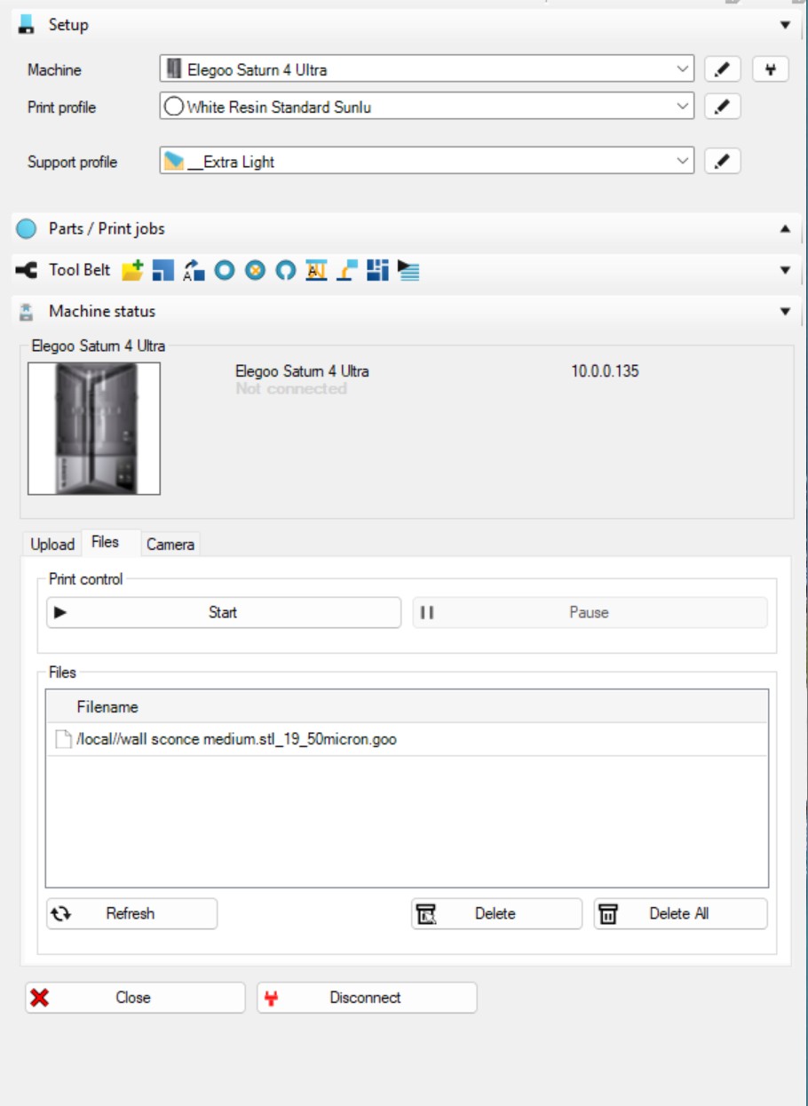

#11
Hi both,
I’ve ordered the saturn 4 ultra. It will arrive wednesday and i’ll have a look than what is causing these issues.
I’ve tested the entire implementation on a prototype machine from another manufacturer; assuming that ctb uses a uniform protocol accross all machines/pcb’s. Lets see what this brings.

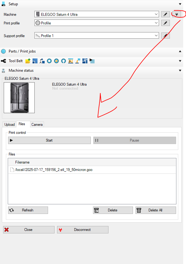

Hi Scott,
I finally received our saturn 4 ultra and was able to open it up and connect.
I just open the software; add the printer from the online environment and click the connect icon next to the printer selection. It results in the machine status opening; automatically scanning the network; finding the machine.
Then you just click ‘connect’ and it should show you the file list as well.
Alternatively you can open the ‘upload to printer’ command (slice menu). (2nd screenshot below)
Thsi will open roughly the same tool in a dialog. there you can enable the ‘log’ checkbox and see what it sends/receives. Check this box and then click connect.
Can you share a screenshot of what you see?

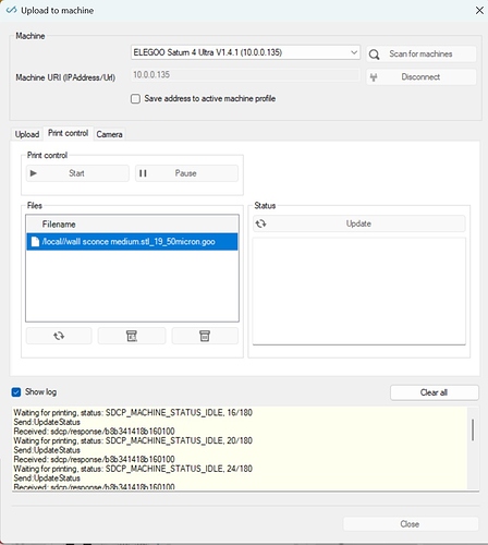

Hello Elco,
I have duplicated the print dialogs with screenshots. *see attached

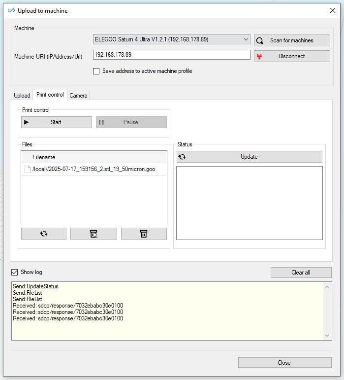

So in the top screenshot; if you just select the file and press ‘start’ it doesn’t work?
The bottom screenshot looks strange to me; i’ll have to check that. Or it hangs in some kind of uploading mode; or it’s because it’s already connected in the toolwindow. Might be there is something blocking double communicaton to the machine.

Hello Elco,
That is correct. When I press ‘start’ the log file keeps repeating SDCP_MACHINE_STATUS_IDLE and the machine does not run. It will do this repeatedly until I force close the application through the task manager.

Hi Scott,
I think i found the root cause of this problem. Our software was not parsing the response of the status call properly. The documentation mentioned a format for a specific number as ‘0’ but they return ‘0.0’ from the machine… this apparently only happens when the machine is in use for a couple of prints. that’s why i didn’t notice in testing…
I’ve made our code a bit more flexible now and will try to push a fix later this week. I hope this will fix all the issue with it.
